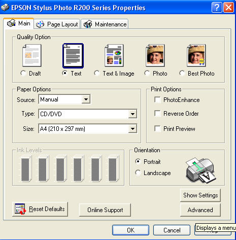

    However I just reformatted my computer due to some other issues. I went through the usual process of reinstalling all of the software, and I re-entered the preferences that I used before in the Epson Print CD program (Premium glossy photo paper/Microweave/Photo Enhance/).

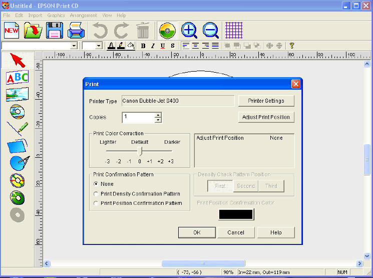

    When you click the print button a confirmation screen pop's up,
    There is a brightness slider right there....

    I know that you can change the brightness from the first print screen, but I never had to do that before, and want to find out what the problem is.
    Thanks, but I already addressed that issue
    I want to find out what is causing the discrepancy so I can FIX it instead of applying a band aid fix.

    Click the advanced tab and it will bring up more option settings.
