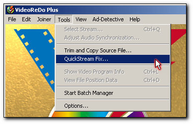

    Firstly, thanks for the sample & logs. Well it looks like the timestamps are all over the place in the sample... (not sure of the source of these files - maybe a TV capture?). In order for SVCD2DVD to process them correctly i had to first use VideoReDo's "Quick Stream Fix":
    Thereafter the conversion went fine. Can you try & confirm on the whole file?

    Tried video redo. It took about 5 minutes per file to fix. Finished DVD works great now. Thanks!!!
