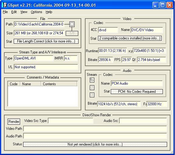

    OK. I downloaded GSpot and here is what I get for one of the files.
    I did learn one thing out of this though. The bitrate shown in Windows Explorer is Audio bitrate and not the Video.

  8. Member edDV's Avatar
    Mar 2004
    Northern California, USA
    The DV video was encoded with hardware in the camera. All you are doing during "capture" is transferring the data. It is possible to have data drops during the transfer but otherwise there are no changes to the video or audio.
    WinDV is good and simple for doing this transfer of data.
    Next you can edit the DV or go straight to encoding the DV to DVD MPeg2. It is this process that squeezes the 25 Mb/s video down to approx 8 Mb/s. Then you author the DVD by adding menus and muxing the MPeg2 video with audio, and other data streams. The result is the Video_TS directory with bup, ifo and vob files that the player will recognize.
    If you are getting a decent transfer, then all the other issues concern Power Director settings.
    The DV looks normal, how about a GSpot for the MPeg2?

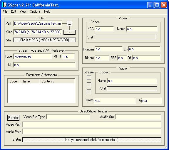

    I encoded one of the avi files to Mpeg2 using TMPGEnc. Here is the Gspot for the Mpeg file.
    Btw, after encoding, the resulting mpeg file has no audio. Why is that ?

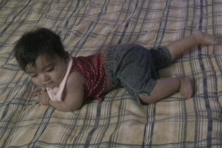

  16. Use VirtualDubMod to extract a frame then post it.
    Apr 2005
    Canada
    I could not open the avi with VirtualDubMod. However, I captured a frame with PowerDVD. Here it is:

    Could it be possible that the snow effect is from using old (time to replace) tapes

    It will look brighter played to a TV. The best way to track quality through the process is to play the resulting 1 Hr. 8 Mb/s DVD to the TV and compare the result to direct playback to the same TV off the camcorder. Make sure that it looks comparable first then you can attempt enhancement filters in a second pass.
    The picture quality looks like typical low light CCD noise. Video quality is at least 50% about lighting. If you see a significant difference between the DVD playback and camera DV original, then you'll have to look at encoder settings or a different encoder.

    Digital recording tape errors don't show up as noise, they show up as lost pixels or lines or full frames. Most often those errors are caused by dirty heads.
    Like this
    http://www.kiva.org/about
  21. I agree with edDV -- the problem is the low light conditions leading to noise.
    One of the main techniques in MPEG encoding is to only encode the differences from frame to frame. When you have nice clean video this works very well. But with this type of noise every pixel changes with each frame. This totally kills MPEG encoders.
    Another technique involves taking advantage of locality of reference. Within small square blocks of a normal picture there is usually a limited amount of detail. For example, if an 8x8 block of pixels is all the same color it will compress very well. Once again, noise makes the video much harder to compress.
    You can try using some temporal and spacial filtering. But there's a limit to what you can do without introducing other artifacts.
    I did exactly what you suggested. I have capability in my TV to split the screen in two equal parts side by side. On one screen I played the 8 Mb/s DVD and on the other direct input from the camcorder, even synchronized them almost frame by frame. The result... they looked the same to me. Only certain scenes looked brighter in the original and some other scenes looked brighter in the DVD. The level of snow was almost identical. Every now and then, I will enlarge one of the screens and whichever I enlarged, the snow became more prominent irrespective of the fact whether it was DVD or the Camcorder. So, it appears the problem is with the original itself. I even cleaned my camcorder heads twice with a brand new Sony Head Cleaner. It probable made a slight difference but not heck of a lot. I had a third tape recorder by the same Canon Camcorder and that one also seems to have the snow problem but not as bad as these two tapes. I still don't understand why the Canon tapes have this issue.
    Now that we have nailed down the problem, is there anything that can be done to improve the quality in terms of filters or Video enhancement tools etc. Also, if you have any suggestions to prevent this kind of problem with the Canon camcorder in the future.

  23. Originally Posted by Subhash
    The problem is in the CCD sensor. They have a baseline noise level. As the lighting decreases so does the signal to noise ratio.
    The best solution is to use more light. Or use a bigger (larger diameter) lens if you can. Or shoot when it's very cold (there is less noise in the CCD when it is cold)! Some cameras have a night mode that takes long exposures (or averages several frames together) -- but this leads to a lower effective frame rate and blurry pictures.

    I agree that in the future you should try more light.
    To improve what you have try levels correction and noise reduction filters while still in DV format, before MPeg2 encoding.
    Restroration is a complex subject. Best to shoot with good lighting and when possible, from a tripod.
