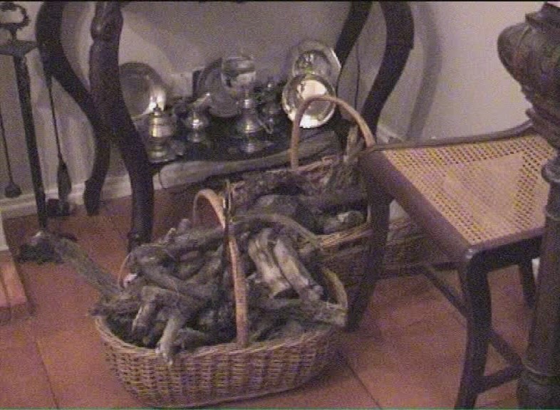

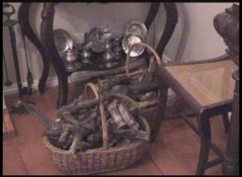

    Nov 2002
    Portugal
    Here go some examples of DVD(Mpeg2) made from my Digital8 camcorder Sony TRV 140, convert with some known software (the number is the "Bitrate"). As you can see the video quality it's very poor. This exemples is the worse, there are another parts of the video that are better then this and some parts nearly perfect with natural light.
    DVD_3000TMPGEnc
    DVD_5000TMPGEnc
    Mpeg1_2200TMPGEnc
    One more thing, the source AVI has the same quality of DVD 5000 and I'm using 720x576 PAL for DVD encode and 352x288 PAL for Mpeg1.
    In TV the quality seems better, but in the PC monitor looks like this images.
  8. Member thecoalman's Avatar
    Feb 2004
    Pennsylvania
    I'll assume by the filename that the bitrate is 3000? That's too low, especially if you're using full frame resolution.
    Edit: You've since changed the image....
    Edit2: Ok, it's back. Anyway that image doesn't tell us anything because we don't know what the original looks like, addiutionally it's been resized .....
    A quick suggestion. Transfer your footage as DV-AVI to your HDD. Convert using 720x480 (or the pal equivalent if in pal land) 6000 VBR, make sure you don't deinterlace the footage at any point and it's set for bottom field.
    Author to disc and it should be nearly identical in quality to what it looks like played from cam to TV.

    one reason that looks so bad is due to lack of light. most camcorders need a lot of light to look any good, so indoor shots will look grainy like that

    You cam is trying to compensate for the low light as mentioned above. If it has manual settings you may want to try adjusting them appropiately. A low end cam like your is going to have minimal if any manual settings. Here's a screeshot from my prosumer GL2 on auto:

  12. Always Watching guns1inger's Avatar
    Apr 2004
    Miskatonic U
    All of them are too compressed for the amount of noise. Either reduce the noise by filtering (and risk muddying the image), or settle for at least 7500kbps and less running time on the disk.
