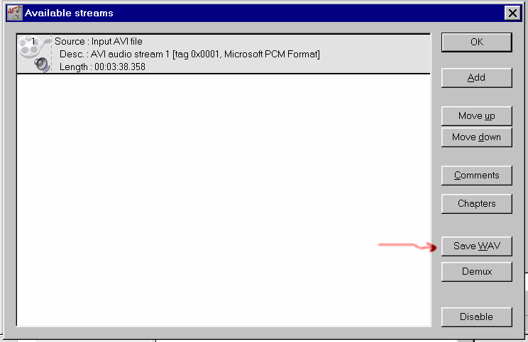

    Step 1) First, we need to generate WAV file of the music video for timing purposes. So open VirtualDubMod, and load your video. then pick Streams, then Steam List.
    You'll get the following dialog box:
    Hit the "Save Wav" button, enter a filename, and save the sound portion only as a WAV. Remember where you saved it. For my test, I called it... "testing.wav". Now you can close VirtualDubMod.

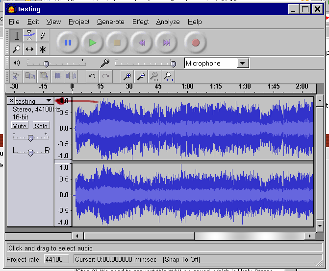

    Step 2) We need to convert this WAV we saved, which is likely Stereo and 16 bit, to 8-bit mono WAV, and we'll need Audacity to do that. So, start Audacity, and load the file, or in this case, "testing.wav". You should see two waveforms, as this is a stereo track.
    v

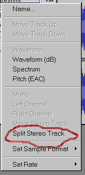

    Click on that little triangle for the drop-down menu... and you should get the following menu. Click on "split stereo tracks".
    Now the two tracks are split. Climb the bottom wave, then do Project / Remove Tracks (or just hit the X of that track). And voila, you're left with only 1 wave track.

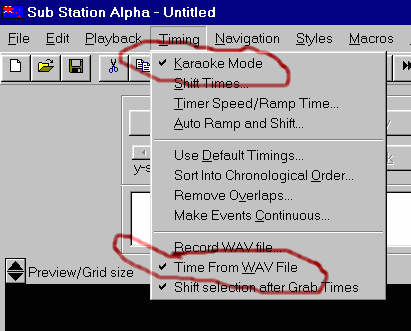

    First, enable Karaoke mode. Go to timing menu and make sure both Timing from WAV and Karaoke mode is set.
    Go back to the first row in the grid, click on it, and see the wave form adjust to highlight the portion you have indicated in the timing.

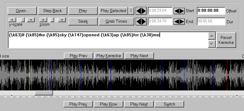

    So far, your text doesn't have any funny symbols, and there are just two lines. Now that Karaoke mode is on, there's a new button to the right that says "Reset Karaoke". Hit that, and you'll see the program inserted a bunch of {\kxx| where xx is an integer. Those are timing markers, one for each word. SSA doesn't support syllable breaks, so you have to use hyphen and space to break apart multi-syllable words. Then SSA would add one marker per syllable. Else it'll only add one marker per word.
    See the blue lines in the wave display between the yellow and red lines? Those are the represent the markers in the text. So far, the values program inserted are just best guesses. Needless to say, its guess is probably wrong, so you'll have to adjust it.
    Do NOT adjust the numbers directly. Instead, put the cursor between the curley braces, and hit "-" or "+" (on the number pad) to adjust the duration of that word. (Note; You do NOT adjust the beginning as that will mess up the rest of your timing) The program will automatically adjust the rest of the line's timing so it will all add up.
    Adjust each individual word's timing until they align properly with the sounds. Use "Play Prev", "Play Karaoke", and "Play Next" to scroll through the different words to make sure they line up with the audio properly. It will take a LOT of tweaking.

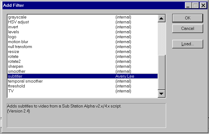

    Step 7) Now load up VirtualDub, and load the music video. Then do Video, Filters, then subtitler. If you don't see Subtitler, you will need to download it and install that before loadingup VirtualDub.
    Enter/Pick the .SSA file you saved from Sub Station Alpha, then click on "show preview" (the screenshot says "hide preview" because the preview window is already showing). Drag the slider a bit and see if your karaoke text comes up. As you can see in the screenshot, it did, with color transition as well. And the size is okay.
