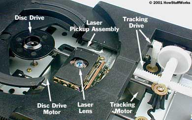

    I clean the lens with denatured alcohol (Isopropyl if you have nothing else available, use 99%) Use a foam 'Q' tip, or a cotton one if that's all you have. Cotton has fibers that can get caught in there. Keep it damp, not wet. Let it dry a few minutes. You may have to partially disasemble it, but you will know how to do it the next time. It looks like this inside:
