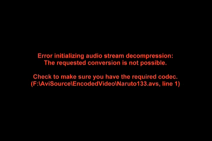

    can someone explain what this means and how to fix it? its an .mpg file that was encoded from an .avs using CCE SP 2.70.02.00.

    It means that AviSynth could not understand the audio from the source. Considering your source is listed as an avs instead of an avi that's probably where your problem lies.

    well...... the audio plays just fine but the video just displays that message.

    I've never tried to load an avs script from an avs script.
    Should you be loading Naruto133.avi instead of Naruto133.avs?

    I am frameserving to CCE. There is my script:
    AVISource("F:\AviSource\Naruto133.avi")
    Lanczos4Resize(660,440)
    AddBorders(30,20,30,20)
    ConvertToYUY2()

    But the error message indicated that in the AVISource line that it is trying to load Naruto133.avs. Did you copy and paste your script or did you retype it?
    Edit: The error message shows line 1 (the avisource line) is looking in the EncodedVideo folder. This is different than the script you have shown.

    i copied and pasted the avs script.
    May 2005
    minnesota
    and i even loaded the avs file in virtualdub and it worked.

    My bad. I just realised that the error is not showing line 1, it's showing the avs file. sorry

    What does the properties show for the audio in VirtualDub?

    what info do you need?

    I need to know what the File Information says about the audio. Format, # of frames, Total Size, and Skew.

    Format: 48Khz Stereo, 192Kbps Layer ll
    # of frames: 4191
    Total size: 2358K

    sorry for all the trouble man. it was working fine just 2 days ago. the audio on the final MPG file play perfect but i think its the video. i have no idea what wrong.

    I don't use CCE, but I suspect it doesn't like the Layer II. Use VDub to Save wav and then use
    WavSource and AudioDub in your script.

    I never use CCE do any audio conversion. If you have an audio editor that can output the required format (I use Sound Forge), use that instead.

    im not using CCE for audio conversion. im using Besweet to convert to mp2.

    In that case, just add .KillAudio to the AviSource line.
