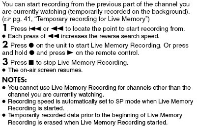

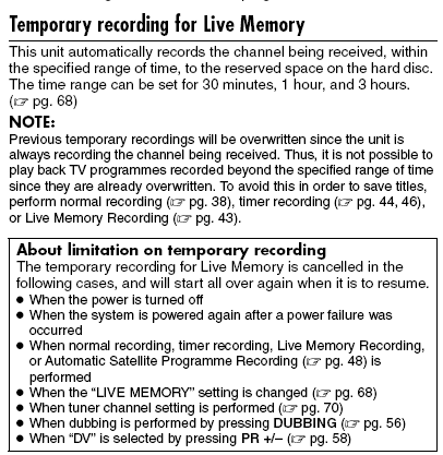

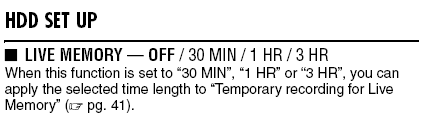

http://books.jvcservice.com/download/441432716/34247.pdf
JVC calls the "buffer" "temporary recording for live memory".
Here is how it is set up. It does not indicate any capture mode ( XP, SP, etc. ).
but when recording from the buffer, it does it in SP mode described here,
The manual does not explicitly say the recording is real-time but I suspect Spyder696969 is right since no recording mode is specified for the original capture to the buffer, but SP is specified for the recording from the buffer. Any difference ( such as XP to SP ) would cause re-encoding. -

I did some tests on my M30 to answer some of these questions. I can add titles, add chapter points, change the thumbnail clip, and add a category (sports, film, tv, etc.) to my clip and still do a high speed dub. If I trim 15 seconds off the front or 1 minute of the end or split the clip, I can’t do a high speed dub. The SP on my hard drive looks like the SP on my DVD. Even if I use the manual setting it still looks the same. I don’t believe there is any re-encoding going on. If I change the SP clip to LP on my DVD using the manual dub I can see a difference.
I had to enable the live transfer because I had never used it before. The transfer from the buffer to the HD is almost instantaneous. The live transfer recording does not transfer in real time. I watched the scifi channel for almost two hours. I then backed up the live transfer to 6:00pm. I hit record and the recording timer went from 0:00 to 1:59 in a second. I then hit stop after 30 seconds. The 1:59 minute video was on my hard drive. I didn’t have to wait 2 hours for it to transfer.
Two things I discovered. The live transfer recording used the FR65 speed. I’m guessing this is very close to the XP speed. It did this all ten times I used the buffer for recording. I see why someone said the buffer looked good. It looked good to me too, because I rarely use the XP speed setting. When I tried to transfer the 2 hour recording to a dvd I couldn’t because it wouldn’t fit on the dvd.. The other clips I made were all 15 minutes or less and they all transferred to dvd at the FR65 setting. I now the manual excerpt from the thread says the live memory recording will automatically set to SP, but it didn’t happen the ten times I tried it. I looked twice in my manual and I couldn’t find a recording speed. I’ll check again.
The live buffer works great and you can change the channel with it. But you can’t record from multiple channels. Live memory recording only works from the last channel your watching. I can backup and watch multiple channels but I can only record from the current one I’m watching. If I have 1 hour watching my current chaneel, I can only record from 1 hour out. There is also a 5-8 second delay changing channels when the live memory is on. When you turn it off the channel speed goes back to normal. -

It looks like the live buffer on my machine is set to FR65. I tried five more times and the speed was always FR65. I even tried adjusting the speed manually, but it wouldn't work. The live buffer recording on my machine can't be changed. I did try the XP to SP re-encoding on some of my clips. They looked exactly the same as on my regular SP high speed dubs. I couldn't see any difference between the two. Of course, my eyes could be worse than yours. Your best bet is to check it out for yourself. -

I finally found the info. It's on page 45 of the my manual and the manual online. It does state that the recording speed is set to SP. I wondering now if the manual is wrong or is my unit defective? Everytime I do the live memory recording it records at FR65.
