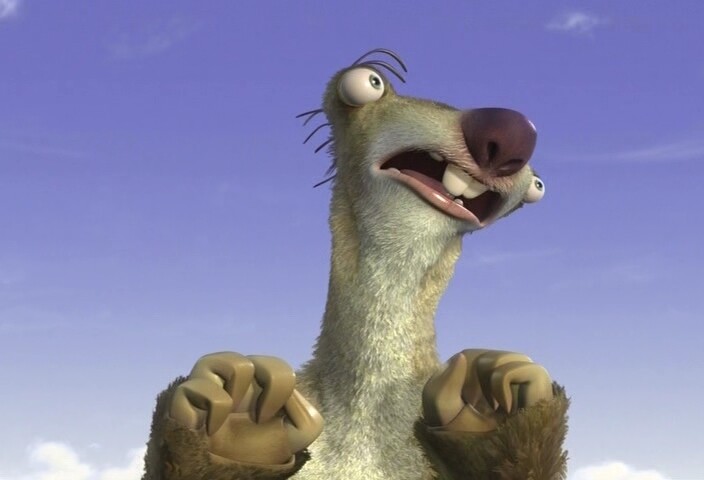

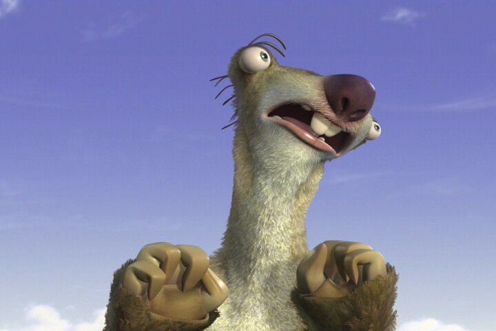

The rumour about the Panasonic DMR-ES20 having an LSI encoding chip is true. I just got hold of an ES20... opened it up, removed the heat sink and the unit in fact has a LSI DoMiNo DMN-8602 encoding chip. What's more, the ES20 records full D1 at 720x480, not 704x480 (the "cropped" D1 format) like all the previous Panasonics do.

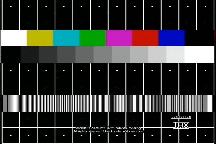

I made some quick test recordings with the DV and s-video inputs - same method as always... I used my Pioneer DVR-320S as the source player.
Panasonic DMR-ES20, DV input, SP mode
Panasonic DMR-ES20, s-video input, SP mode, Line-In NR Off

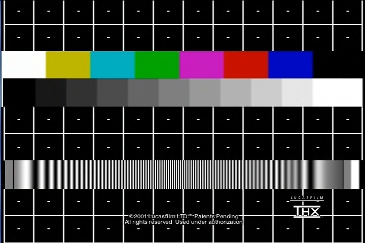

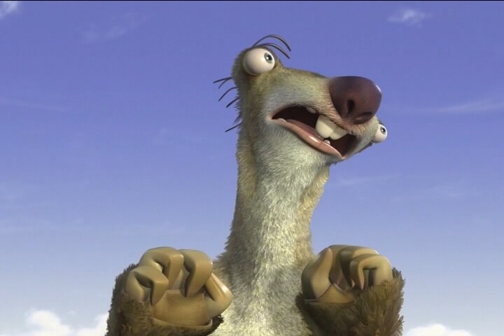

I have an ES10, too. Here's what the s-video input recording looks like using the identical method (Pioneer DVR-320S source player)... I shut off the input video noise reduction to achieve the sharpest picture possible.
Panasonic DMR-ES10, s-video input, SP mode, Line-In NR Off
The ES10 has a softer recorded image than the ES20. Also, it crops 16 pixels from the left and right frame edges (704x480 format). The ES20 records in full D1 format 720x480.

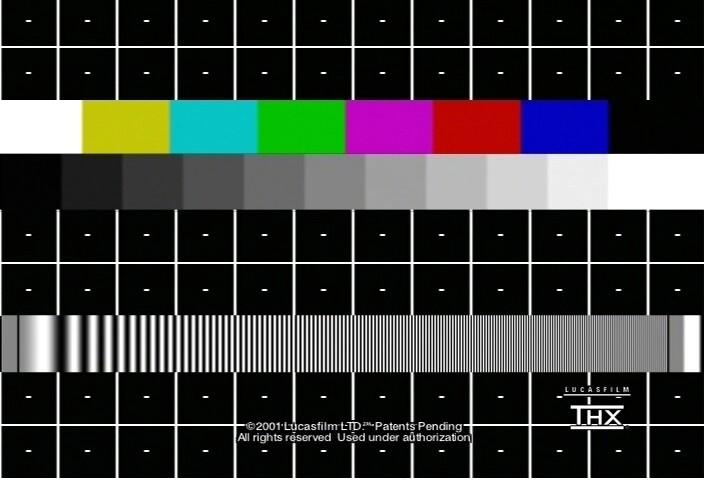

For reference, here's what the THX test disc frames look like:
THX test disc frame grabs:
The ES20 recordings, especially using the DV input, are the closest to the original test disc in terms of sharpness, color, black level, etc. Plus, my experience with other LSI encoding chip based machines is that they make better looking MPEG2 recordings overall, with fewer artifacts. The Panasonic proprietary chip that has been used in all their other units produces noticeable macrobocks, especially on recordings longer than 2 hrs. -

I have an ES10 on hand, as well. I posted some frame grabs in the post before yours. The ES10 still uses Panasonic's encoding chip (captures cropped D1 704x480) with the familar artifacts like macroblocking beyond two hours.
The ES20 definitely records a sharper and more accurate image than the ES10, as far as I can tell. Check the frame grabs above and you can see the ES10 has a softer recorded image. As for hybrid VBR encoding, the ES20 does have FR mode recording just like the JVC does. I'll have to make some more recordings, particularly with high action scenes to see how they look. I haven't had a chance to dig into the machine very much yet, so I don't know when it drops to 352x480, etc.
I find it interesting that Panasonic chose to use an LSI chip in this particular machine, the first time they have done so as far as I know. I wonder if they've finally given up on using their own crappy encoding chip, or if this is a cost savings measure to make the ES20 more competitive at the retail level. -
The ES20 picture does look sharper than the ES10. But I don't believe that it has a Sync Filter like the ES10. When I try to record a VHS tape and use the ES20 as a Pass thru. It didn't do the same thing as ES10 did ( no correction in terms of video jittering). I think they chose to use LSI because of Complaints of Marcoblocks. Have you compare it to the JVC yet. I might try to pick up a ES20 to see do I get the same result as you have. Nice going gshelley61!

I have been looking at the test pattern pic you posted for the:
** Panasonic DMR-ES10, s-video input, SP mode, Line-In NR Off
And, I can't help notice that it looks the closest to the original
THX pattern from your dvd disk.
IMHO, I would have to say that the ES10 does a better job at retaining
(or reproducing) the test pattern image to the closest detail. That
means, that the ES10 has a chip (IMO) that does better job on the
sub-sampling process than the ES20 chip's.
I read earlier in this topic, how it was suggested that the ES10
has a slightly more softer look. I don't agree. I think that they
both look the same, sharpness wise, but what might be overlooked, is
the sub-sampling of the color space for each of the unit's chip process.
On the ES20, you can see how some of the color's bleed into the next
block. But on the ES10, its much less.
Now, I noticed this right away, on account of my current research and
study of yuv and sub-sampling processes. And, because I am deeply
involved in this area, it was all too easy for me to spot, quickly.
Also, because I used the original THX test image that gshelley61 had
posted here. And, I spent a good part of the day, studying and runing
various test scenarios of sub-sampling (via my yuv tool I'm developing)
and the results aftwards.
It is my honest opinion, that we need to first view the method of the
sub-sampling done for these units. Then, comes the overal picture
quality. Mainly becase these units incorporate various kinds of filter
processes. And, they can be anywhere's, from before, during, and/or
after the sub-sampling stage.
Last, it is also my opinion, that the sub-sampling step is a form of
filter on its own, and could be viewed as such. Therefore, I truely
believe that we talk about image quality from these devices, that it
is very important to first look at the sub-sampling results. To do
this, would require some test patterns, such as the ones that gshelley61
has posted here. These serve as good references, mainly on account of
the color blocks and how you can discern "bleeding" across each block's
bounderies.
@ gshelley61
If you could post *other* images that would show more RED colors, that
could (or might) help bring better conclusions on the overal picture
quality. What we are after here, is how well the *each* unit's chip
does in its processing. In this case, we are looking for how well
each chip handles (processes) during the sub-sampling stage.
I leave that up to you to consider
