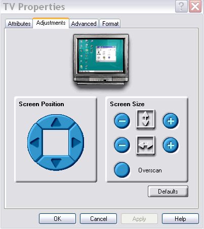

    All the adjustments are in the Display Properties - ATI advance settings

    I don't use overscan, I just adjust the H and V frame to the edges of the monitor.

    When I do that, the image will stretch until a certian point(a black bar), after stretching it more, it will just think its going off the TV but its being masked behind a black bar. Sorry I dont know how to explain better.

  9. Play a movie before going to the ATI's video properties dialog. Then another button will appear below the Overscan button -- called Video. Try turning that on.

  11. You might also have to be in Theater mode. In Theater mode you can play a video in a window on the main desktop but the video will be full screen on the TV (you won't see the desktop on the TV while the video is playing).
