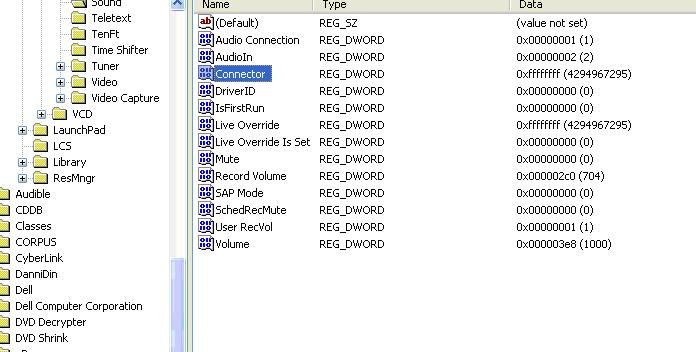

    I'm not a registry kind of guy, but this is what I see to the right of the Record Volume line: 0x000002c0 (704). Does that mean my default is 704???

    This is what the registry looks like:

    Lord Smurf, any update on this old post? Can you comment on my registry? When capturing using TV, does changing the volume on the software control panel actually change the recorded volume? I can't determine if it actually does or not.....

    BTT. Can anyone comment on my registry listings and the volume problems, and how to correct them?
