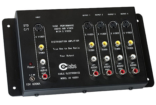

The next alternative would be a active splitter, something more complex than just a 'Y' cable adapter. Maybe something similar to this:

The "active spliter" should do the job. These are usually called a "distribution amplifier" in the trade.
