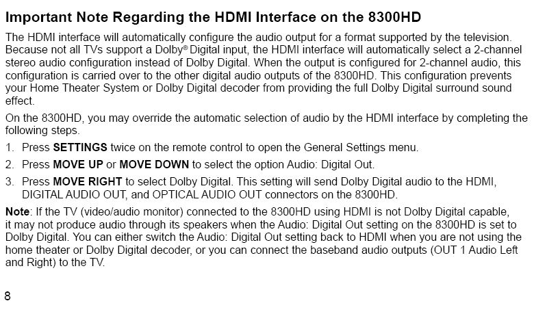

I had to dig this out for a friend on Time Warner.Originally Posted by ebenton
Join the Scientific Atlanta explorer club to get the real documentation that even the Time Warner tech leads seem cluless about.
I'm beginning to suspect and fear that HDCP encryption may force audio over the HDMI. I sure hope this is not true but alot of equipment is defaulting that way.
http://www.scientificatlanta.com/ExplorerClubGuides/getting_started/4003987.pdf
go to the bottom of page 8
Added OOPS: they changed the link for the HD model to
http://www.scientificatlanta.com/ExplorerClubGuides/getting_started/4003986.pdf
and the info is now on page 11.

Apparently my cable company has deleted the Audio: menu selection from my 8300HD.
See my revised link above. They changed the site.Originally Posted by ebenton
The cable company has wide latitude as to which features are enabled but you can at least get way ahead of cable tech support by reading these manuals.Recommends: Kiva.org - Loans that change lives.
http://www.kiva.org/about -
Here is the one I asked them to answer all the way up the chain and Time Warner still takes the position it is impossible. At least as of July.
After bitching to my cable company about this and being put on hold several times while they talked to "supervisors", they informed me that the availability of this menu selection is based on a firmware upgrade to the DVR, which they have not yet pushed out over their network.
I have had the DVR for almost a year now, so it is possible that I have an older firmware version.

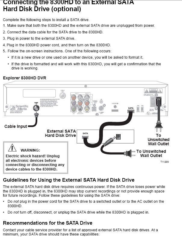

The SATA thing looks promising, too, if it ever happens.
