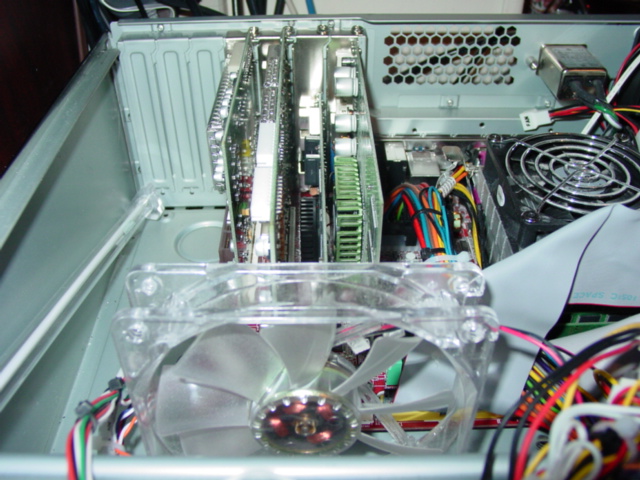

Beyond TV is great. Been using for over 3 years. Currently using Version 4. Have 4 TV Tuners in my PVR Box with 1 TB of storage. The amount of features are unbelievable. You name it, it can do it. TIVO doesn't even come close. Media MVP which I also own is fine for accessing content already recorded. But if you are going to build a PVR, hook it up to your TV. Use it like a TIVO. You can watch shows while they are being recorded. Fast forward rewind etc. Consider buying the PVR 500MCE version (Two Tuners). I run 1 500 MCE, 1 PVR 250, and an NVPVR Tuner. Beyond TV now supports FM radio as well. The 500 MCE has FM radio. You can build a nice system. I have thoroughly enjoyed mine. Oh and one last thing, a nice feature is you can be anywhere and send a remote recording to your computer (as long as it is on). Several times I have found out something would be on and accessed my account via snapstream and sent a remote recording to my computer to start recording. Nice feature as well.

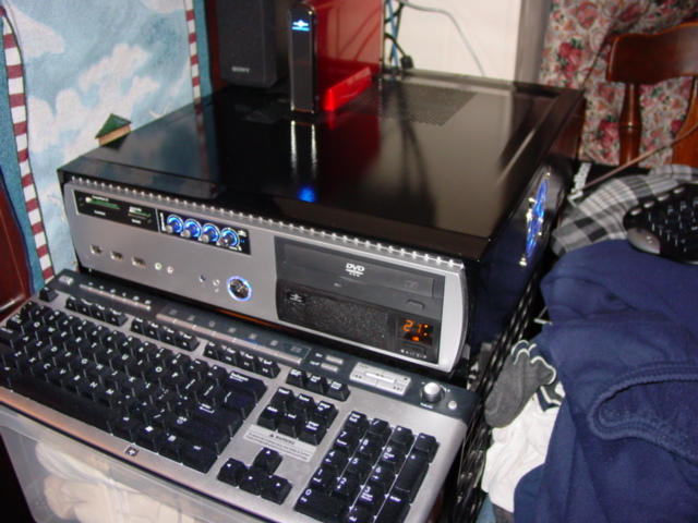

You need to consider building a dedicated system to handle your PVR duties. This way it stays clean of all the other issues. All it will do is access the internet for guide updates and run Beyond TV 4. Yes you can make your own S-Video cable as long as you want, but then how to you transfer the IR signal for a remote? The signal is output through your video card not the tuner. Put the unit in a nice Media case to blend in with your other entertainment components, with plenty of cooling and you will be set. Here is my latest In a Antec Overture II case.

I use the same case as jdizzy40 for my setup. I output from a ATI Radeon 9550 through a ATI DVI to Component adapter to my video projector.
I have 25 foot extensions for the mouse, keyboard and monitor so I can operate the computer from the other side of the room. The computer is hooked into a cable modem for net access.

Redwuz: I added another side fan and installed the fan controller to keep things moving but not be so loud. I also hot glued a 120 mm fan on the end of my TV Tuners to blow air over them. I prefer a computer PVR over a TIVO as beyond TV can when you are sleeping perform show squeeze (remove) commericials and output to a handheld format such as DIVx. Will also sync with Windows Media Player.

I use a AMD 64 754 CPU and SATA hard drives. Both of them run very cool, so the only heat is the ATI videocard with a passive heatsink. The case runs almost silent except for that PS fan. The fan still has some kind of harmonic noise. I can lift one side of the case a little and it quits. I'm not looking forward to taking the case and power supply apart again, but it bothers me. I wish I had put rubber grommets on it while I replaced the fan.

But I decided a dedicated computer would be better and it made sense to use a desktop case. It fits right in with my other audio equipment, though it is a little longer. Now I just have the computer monitor on a shelf beside the couch and the keyboard on a drawer underneath the coffee table.
