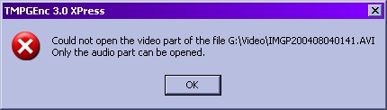

I have a large number of AVIs from my Optio S4i digital camera that I want to encode together as one in TMPGEnc. When I try to put one of those AVIs into TMPGEnc I get an error message saying it cannot do that. I never had this problem before I reformatted my computer. I used to be able to edit those AVIs in TMPGEnc just fine and now I can't no matter what codecs I install in the computer. Please help.
I'm attaching an image of that error message.

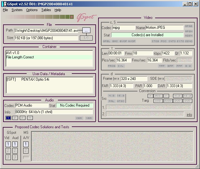

Here is a link to one of my small AVI files. If anyone can figure this out it would be great. http://www.sjnetwork.com/movies/temp/IMGP200408040141.AVI

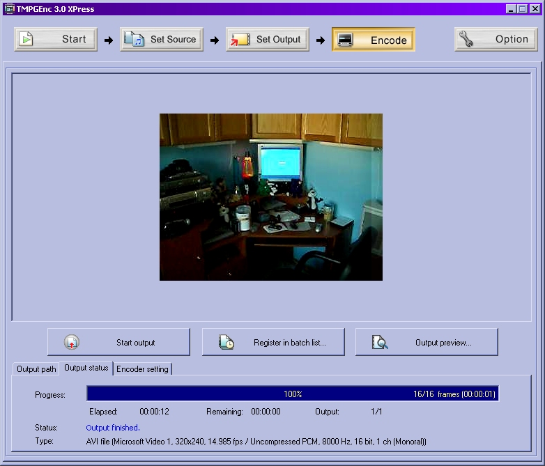

Thank you. I downloaded the ffdshow codec and that worked and now lets me load my AVI files into TMPGEnc. However, now it adds an artifact on the right edge of the picture on each video when the original does not have it. See the two links below, one containing the original file and the second link the encoded file in TMPGEnc. I also have a screen show of the video in the preview window of TMPGEnc and it shows the artifact. It never used to do this before I reformated. Please help.Originally Posted by celtic_druid
Original: http://www.sjnetwork.com/movies/temp/IMGP200408040141.AVI
Encoded: http://www.sjnetwork.com/movies/temp/IMGP200408040141new.avi
