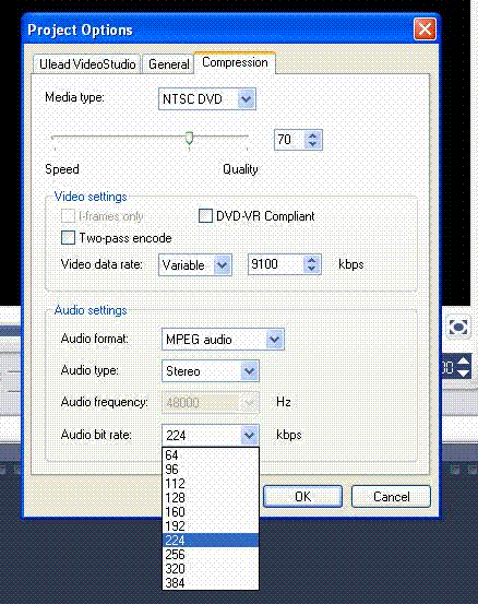

    I've just upgraded from Ulead VS7 to VS9 and a friend gave me his Sony DVD Mini Camcorder to combine a couple mini discs to 1 DVD. I've transferred all the files from the camcorder to the HD and I imported a clip just to check the properties so I could match them up with the project settings. I've checked through the guides, but don't see anything obvious that pertains to this particular setup. So this is where I'm just a little confused as to the settings I need. Just wondering if someone could have a peek and give me a some pointers.
    Video Clip properties
    File Format: NTSC DVD
    Video:
    Video Type: MPEG-2 Video, Upper Field First
    Attributes: 24 Bits 720x480. 16:9
    Frame Rate: 29.970fps
    Data Rate: Variable Bit Rate(Max 9100kbps)
    Audio:
    Audio Type: Dolby digital audio 48,000 Hz, 2/0(L/R)
    Layer: none
    Bit Rate: 448kbps
    Video Studio 9 Project Options General Tab Settings I've Chosen
    Data Track: Audio and Video
    Frame Rate: 29.97 Frames/Second
    Frame Type: Upper Field First
    Frame Size: 720x480
    Display Aspect Ratio: 16:9
    Video Studio 9 Project Options Compression Tab Settings
    This is the one that stumps me a little as I can't even go that high when picking an Audio bit rate when MPEG Format is chosen. Do I need to "check" the DVD-VR box and then pick "Stereo" or "Dual Channel" as these are the options available when that box is ticked. Havn't done this format before, but would like to match the settings of the project to the clips.
    Thanks for any help,
    Max

    Thanks for the feedback edDV, The only stumbling block I seem to have here is with getting the project settings the same as the MPEG-2 files that I've already added and edited. Can't I then just go directly to Share>Make DVD>Same as project settings and then create the Video_TS and Audio_TS instead of burning DVD.......then>Burn With Nero. I'm just wondering if that tick box for DVD-VR compliant video is all I need as DVD-Video Recorders (I'm guessing it's referring to "Set Top" recorders)should be in the same format as the Sony DVD Mini disc as they can both be played directly in your DVD player. It gives the option of "Dual Channel" or "Stereo" if ticked. I may be mistaken about that point though as I'm just guessing. Maybe there's something in the help files, but I doubt it as the information in there is limited. If I could just get the project settings to match I should be able to just create the files and burn with nero

  8. I've read through these posts.
    It seems to me the confusion begins when you select your DVD audio type.
    Your screen shot suggests you are adjusting your audio to be "MPEG Audio."
    Why?
    That audio type doesn't match the audio type specified by your source clip properties, which read:
    "Dolby digital audio 48,000 Hz, 2/0(L/R)"
    So instead of selecting MPEG AUDIO, it would seem more logical that you would instead select AC-3 AUDIO in the AUDIO FORMAT drop-down list.
    I just did so in MediaStudio Pro 7.0 and then I was allowed to access the 448kbps bit rate.
    If you are selecting MPEG AUDIO, you will force a re-render of your source audio.
    Remember, "DOLBY DIGITAL" refers to AC-3 DVD AUDIO.
    So to avoid a re-render, you should selected AC-3.
    Version 9.0 of Ulead VideoStudio features full support for AC-3 (unlike version 7.0).
    So you should see the AC-3 option in the drop-down list of Version 9.0. If not, there's something wrong.
    FYI: The AC-3 plugin is a $29 option for Ulead Video Studio.

    Thanks for the help Jerry, I'm going to check it out, but I don't remember seeing AC-3 as an option....I don't think I have that option in VS9 and if I don't I'll be really P****d off as that's why I upgraded in the first place was to get the AC-3 capability to handlle this particular type of audio. I may be wrong though I'll have to check it out before I "go off" on Ulead for charging extra for something that should be included in the forst place or I might as well have stayed with VS7.......... Re: Dolby AC-3 stuff just had a quick look and it appears that it should do this "Support for All Popular Formats - You can work with almost any video, image and audio file formats available including AVI, MPEG, QT, Sony MicroMV™, WMV, BMP, JPEG, GIF, TIF, MP3, Dolby® Digital, AIFF, WAV and lots more." Hope this isn't just a blanket B*S* statement

    Just an update on the DVD Mini Camcorder Saga, Did pretty much as Jerry said but had to do it in the Custom settings in Share>Custom>Then, Set the properties the same as the clips noted in the previous posts, including 16:9 format and Dolby Digital Audio. I guess it's important to note that these settings are not available when choosing MPEG format defaults in File>Project Properties..........The encoding process didn't take much longer than an hour to finish so I'm sure there was some smart rendering going on there. Normally this step would take around 3 hrs to complete a 1.5 hr project into a MPEG II compliant video file ready for authoring to a DVD file. Once burned onto a DVD everything looks great with the 16:9 format and no problems with Stretched or Squished looking video. It does bother me that I had to be directed to the "Custom Settings" to set the project settings. Once I found out that all the settings required were available there it was pretty much a snap. I guess you live and learn with the help of others. I never noticed the preview screen go "Black" when the rendering was being completed, but I might mess around with the smart rendering a little more later. As far as bringing in the Video and pics, from the mini DVD discs I just copied them directely from the camera to my HD using the Sony software and found that to be a very painless process. I then just inserted the video clips into the project timeline. Again Thanks for the help. I'll try and help with anyone's questions if I can
