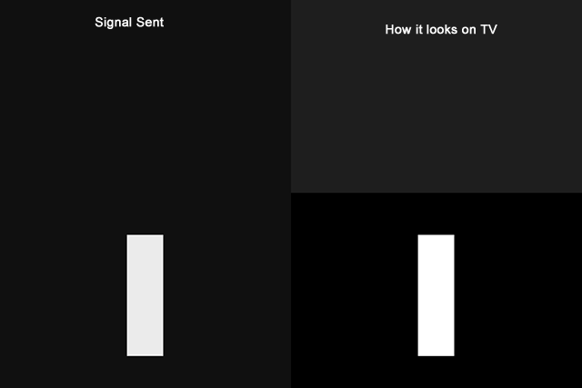

I know, but my TV is PERFECTLY calibrated right down the harsh colour bar NTSC standards. But it's still riding the levels regardless of calibration.Originally Posted by Krispy Kritter
AGC? Is this a real feature they are putting into TVs now? I think the feature sucks, because it says then that your levels MUST hit 7.5IRE and 100IRE for EVERYTHING. So, even if you have a dark scene that hits only 40IRE, everything gets boosted up, because there is no high levels to normalized the range.Originally Posted by edDV
Is there anyway to turn off this Automatic Gain Control, or if a TV has it, then you're stuck with it.

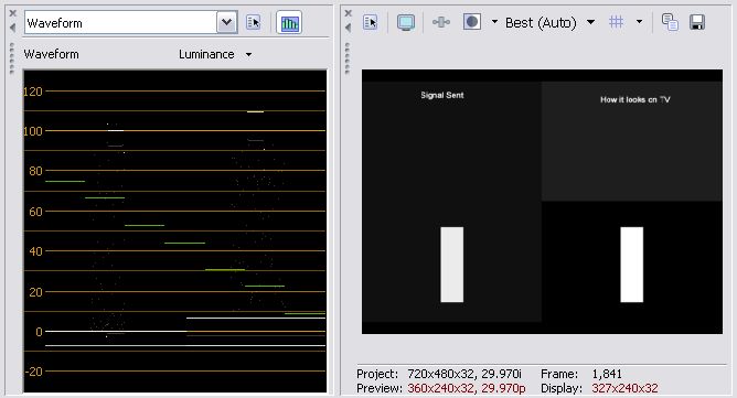

Here's another thing to think about it. Right now, my TV is sitting in video mode right now with only 7.5IRE black being sent to it (From my editor). It's doesn't look black, but a very ungly grey (again on calibrated NTSC bars). If I send a image with anything that hits pure 100IRE white, the grey-black, becomes pure black.
I've attached an image to show what the TV is doing. Again, the black levels look different, but they are in fact the same.
That doesn't sound good to me either. Almost like the high voltage is weak. I'd look at a similar set in the store and see if it behaves the same way. Maybe you could do a test DVD and take it in.
I have a cheap Advent utility TV that does something similar (~15IRE black) on startup but then settles down to correct black after a few minutes.
Your signal on the left shows correct 16-235 digital levels. Right picture shows black at 32 and white at 255. Everthing is shifted up in brightness 7.5%.
The manual for that TV does not mention AGC or any of the fancy color management modes available on the high end models. It just has normal brightness (black level), contrast (white level), color (saturation) and tint (hue).Recommends: Kiva.org - Loans that change lives.

I've had 2 versions of this TV. I had a 15 inch a while back, and upgraded to a 20 inch. Both have this exact same characteristic.
I have also moved the TVs to different sources (eg, not my editor), and it rides levels for EVERYTHING. DVD, DTV, cable. Whatever comes it, it tries to force the 7.5-100IRE the best it can.
This is the reason that black is registering at 32, because it's assuming 16 coming in is 0-IRE, and with no high levels to prove it,it boosts it up 16, making black become 15-IRE.
When it sees that there is white in the second picture, now, 16, stays at 16, etc, etc.
And again, this is not just from my editor, but ANY source.
I'm guessing there's not much I can do, but get a different brand of TV. What sucks is, it will be a hit and miss whether the TV I buy will have this built in "Automatic Gain Control" (AGC) or not.

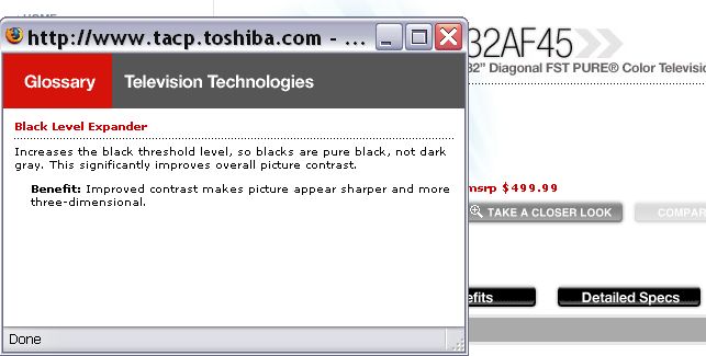

I see nothing in the Toshiba manual that says it is self adjusting levels.
The higher end model has a feature called "Black Level Expander"
