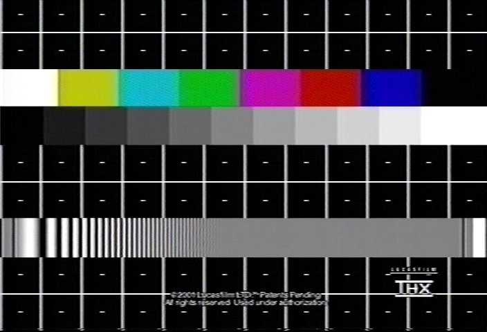

  12. Here is an original THX test image from a dvd movie, "ICE AGE".
    This is that image after it was recorded from a Panasonic dvd player into a Sony VCR using a Sony tape in SP mode. The VHS tape was then played back from the Sony VCR into a Panasonic DMR-ES10 dvd recorder.
    This is the result when the same image is copied directly from the Panasonic dvd player into the Panasonic recorder in SP mode ( 2 hour mode ).
    The same except recorded to the ES10 in LP mode ( 4 hour mode ).
    Some of the images were resized to 640 by 480, the VHS capture image was not. There are many recorders and capture devices capable of mpegs of this quality. A number of them were tested on this thread,
