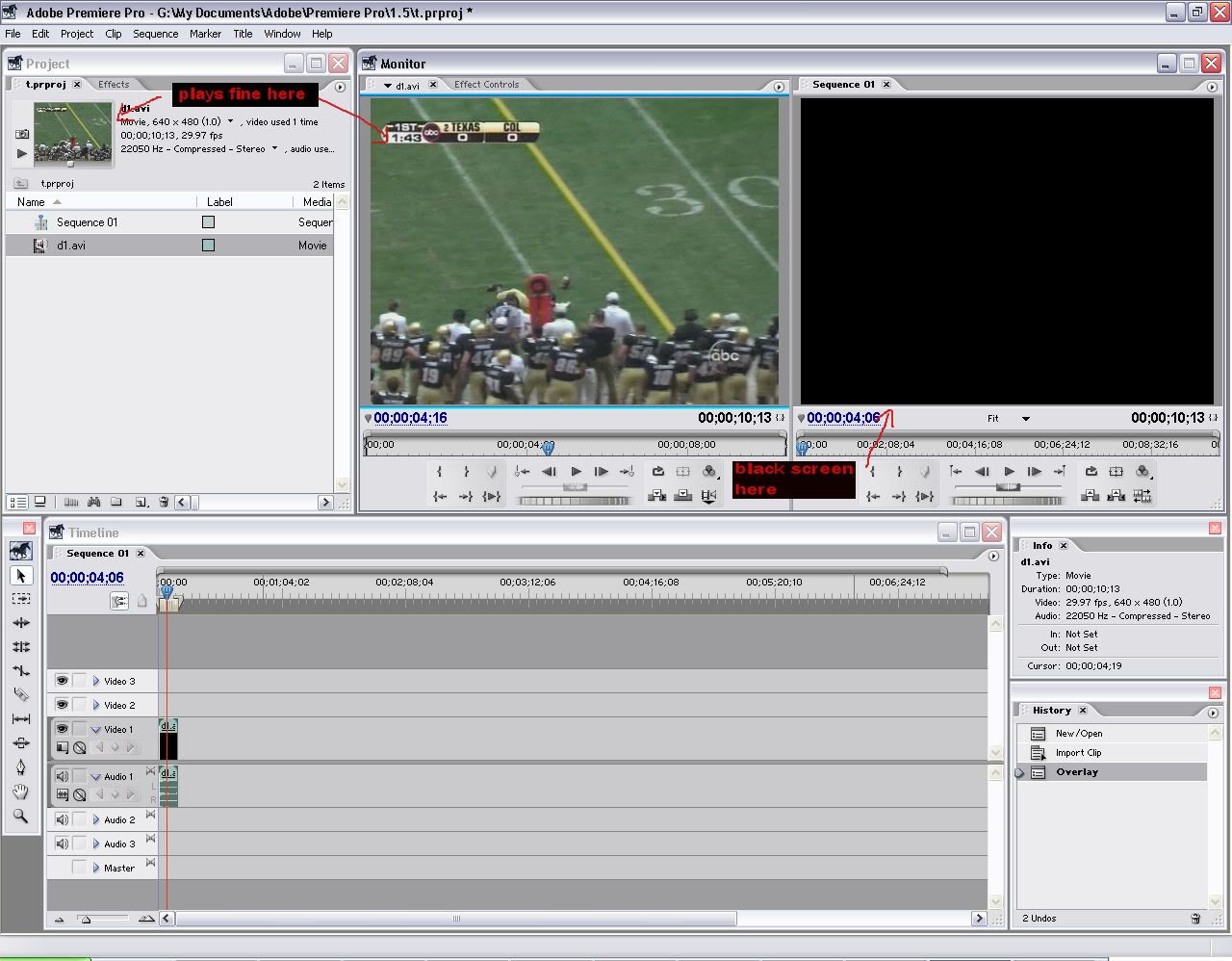

    Using premiere pro 1.5 and xvid.
    i can import the xvid encoded videos into premiere fine, but the probem is when the imported clips are in a sequence.
    when i try to play the sequence timeline, all the preview window shows is a black screen (sound works fine).
    however, i can double click these files in the project pane and have them play fine in premiere induvidually.
    divx encoded clips are playing fine from the sequence pane.
    I've tried huffyuv, xvid, microsoft windows media 9 as possible "video rendering" "compressor"s and i still get the black screen.
    please help!
    thanks!

    What is the overlay effect for ?

    it came there when i dragged the clip from project pane to timeline.
