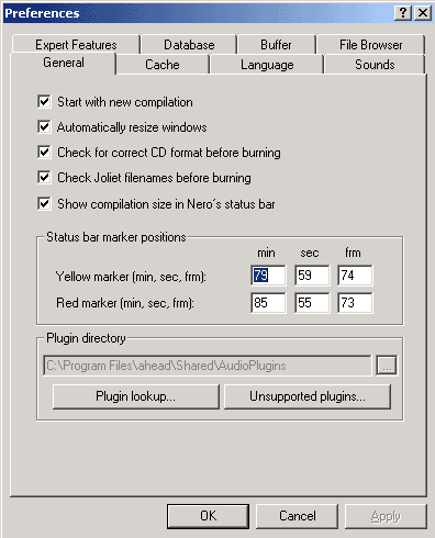

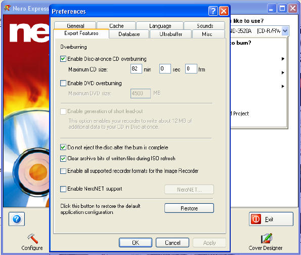

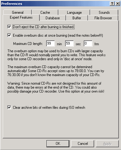

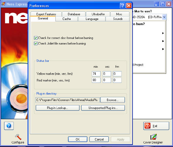

    Just go into configure in nero and set the markers to what you want and the size you want to be allowed to be burned.
    I used to buy 99min cdr's byt 100's that i overburn in nero.
    These are the setting's i use for the 99min cdr's.
    But be careful because if you use a smaller sized cdr and try to pack alot more onto it it will mess up any info on the cd near the end and could poss. wreck your burner.

    But if the burner will NOT allow you to overburn, the software will not allow you to select "overburn", and even if the burner will allow you to overburn, you still have to set the program you are using, as in NERO, to burn the extra data, even with it set to a higher limit it will ask/tell you that you are wanting to burn more data than what the standard is & you have to choose yes, because any program's i have used does not see the over sized cd-r's as what they really are.

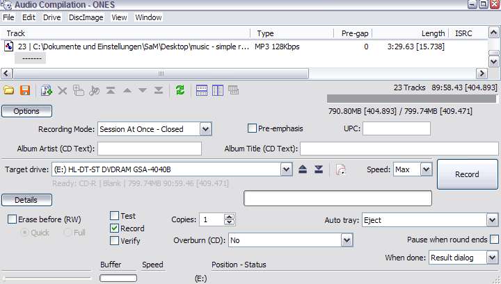

    With Prassi Ones , my LG4040B and recording 81 minutes to a TDK HC-R90 (90 minute/800MB) CDR....I do not need to click/check "overburn" for the CD to burn correctly...I just burned one yesterday.

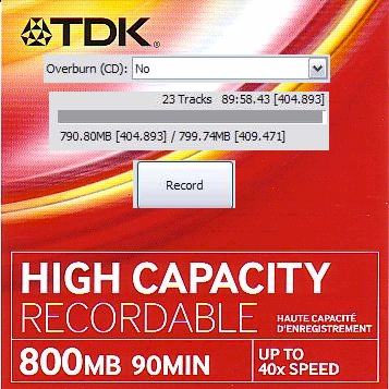

    As you can see....the CD reads as 799.74MB available and I am using 790.80 MB for this particular demonstration....Overburn is set to NO and the record button is still available to me as an option.
    Going OVER 799.74MB on this particular CD would be overburning.

    Umm...druid?....my point is that I am NOT overburning this CD because it(my recording project shown above) is UNDER the 800MB/90 minutes.
    It looks like we need pictures again:
    Burning this CD to almost 800MB or 90 minutes on ANY computer is NOT overburning.
    Infringing apon a CD-R's lead in or lead out area to squeeze a tiny portion more than a CD-R is supposed to hold IS overburning.

    Looks like you guys need to get some new software....or new burners:
