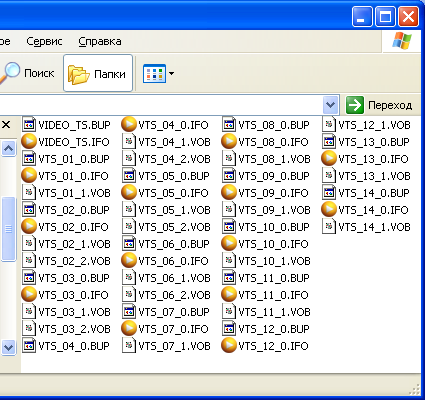

    Hi Ancient!
    Probably your compilation isn't done properly by your authoring software. You need the file VIDEO_TS.VOB so the compilation be correct.
    Actually, I just checked and some of my menu-less DL backups (DVDShrink ReAuthor without recompression) don't have VIDEO_TS.VOB and burned just fine with RN 7.3, like this one of about 7GB:
    So it must be something else in Ancient's case. Looking at the data sizes (second title slightly larger than the first), it could actually be a Parallel Track Path (PTP) disc. DVD+R DL uses Opposite Track Path (OTP) which is very different from PTP. OTP is fortunately more common though. Check with DVDDecrypter if your original disc is PTP or OTP. If it's PTP then read this same post (same link as above):
