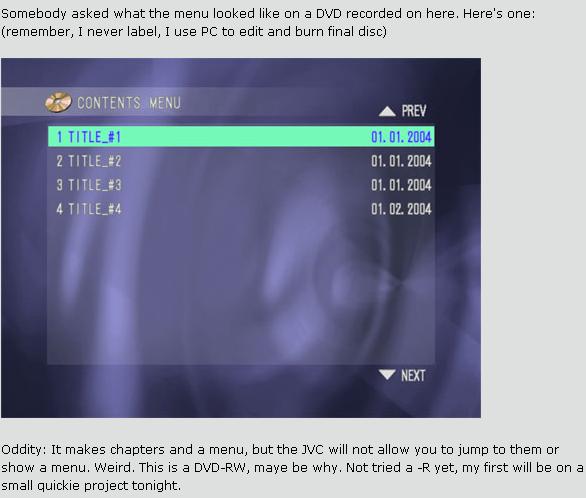

	Lordsmurf may have answered your question on another thread. Here is his reply,
	That is the same menu you get whenever you finalize any disc, whether it is a DVD-R or a DVD-RW. The thumbnail menus, under Navigation, are only there until you finalize the disc and then it changes to the list view, as shown in the picture that was posted.

	I just wanted to clarify one thing about the menu on finalized discs. The menu does not come up automatically like a commercial dvd. You need to press the menu button to see the menu. If you name each title, using the navigation feature, you will know exactly what is on the disc and which title you want to view.
 As far as chapters go the unit automatically puts a chapter mark every 5-6 mintues when it finalizes the disc. You can use the Next or Previous buttons to jump ahead or back through the chapters. You can also use the On Screen button to bring up the On-Screen Bar and select the exact number of the chapter you want to jump to.

 I use MKM, TDK and SONY DVD-RW discs in mine, not really a -R or -RAM user. I edit on the computer and make advanced custom menus.
 The JVC made DVD does not play on all players. Hit play. It'll play the first track. If you want to see the menu, hit MENU on the player/remote. If you want to edit the menu entries, use the NAVIGATION function on the recorder before finalizing. I think "CONTENTS" on the menu is part of the menu image, so unfortunately this cannot be edited. I think -ALL- DVD recorder menus look pretty crappy anyway, so I re-author on a computer, which really does not take long at all.
 Read the instruction book. I think it said it did Type I and II RAM discs. One of those has the caddy, "I" I think it is. Been a while since I read all that stuff, don't use it enough to remember it off hand.
 As far as chapters go, read the instruction book. I think you can insert them, but I don't remember. I'm happy with 5 minute ones for the few times I do DVD-R work instead of DVD-RW work.
