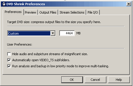

    Nov 2005
    open dvd shrink...edit/preferences/custom then change to 4464 or whatever you want
    if not this then...kinda seems like a bug
  5. Originally Posted by Moontrash
    Tried it and it worked. I set it to 4385 MB which is 4.29 GB.
    I have to agree with you though. It does sound like a bug. I just thought everyone should know about this problem as it can be seriously annoying and time consuming.
