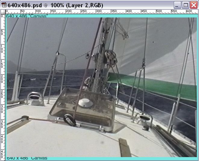

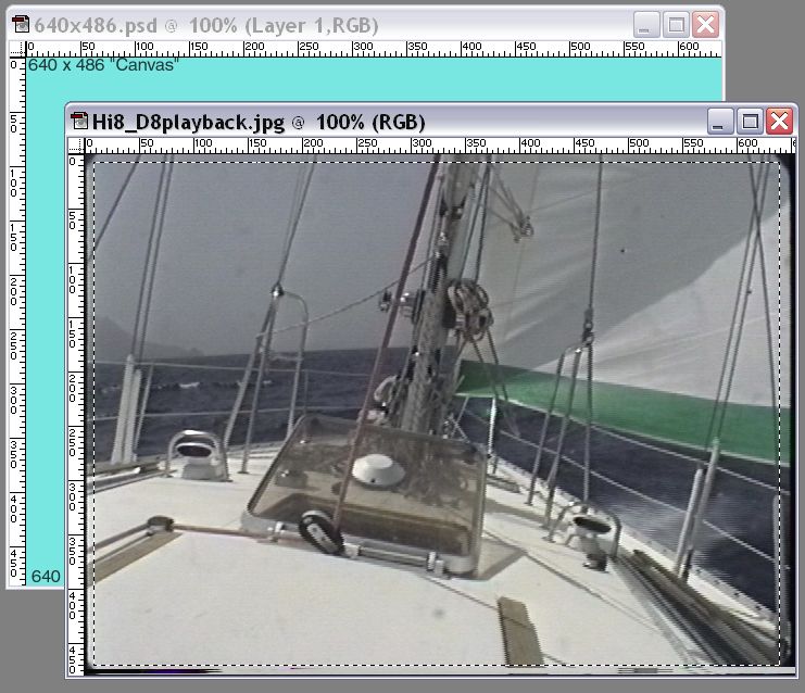

In Photoshop the "canvas" is the backgound frame. Here I created a blank NTSC frame of 640x486. Square pixels would produce 640x480 but the NTSC spec calls for 486 lines (243 per field) in the active picture area so I added 3 additional lines to the top and bottom to fill the space. I made the canvas blue to make it show up. Normally this would be colored 7.5 IRE black. PAL would be 768x576 at 0,0 IRE black.
Also shown below is a Hi8 capture shown in square pixels. The edge defects will be cropped and the result pasted (composited) into the center of the canvas (NTSC frame) without scaling.
And the result
TV overscan would mask the canvas area. It would show as a black border when viewed on the computer.Recommends: Kiva.org - Loans that change lives.

Yes, the canvas is the sampling grid of pixels that is created after capturing an analog video signal into the digital domain. The canvas can arbitrarily be 720x480, 640x480, 352x240, etc.
