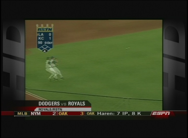

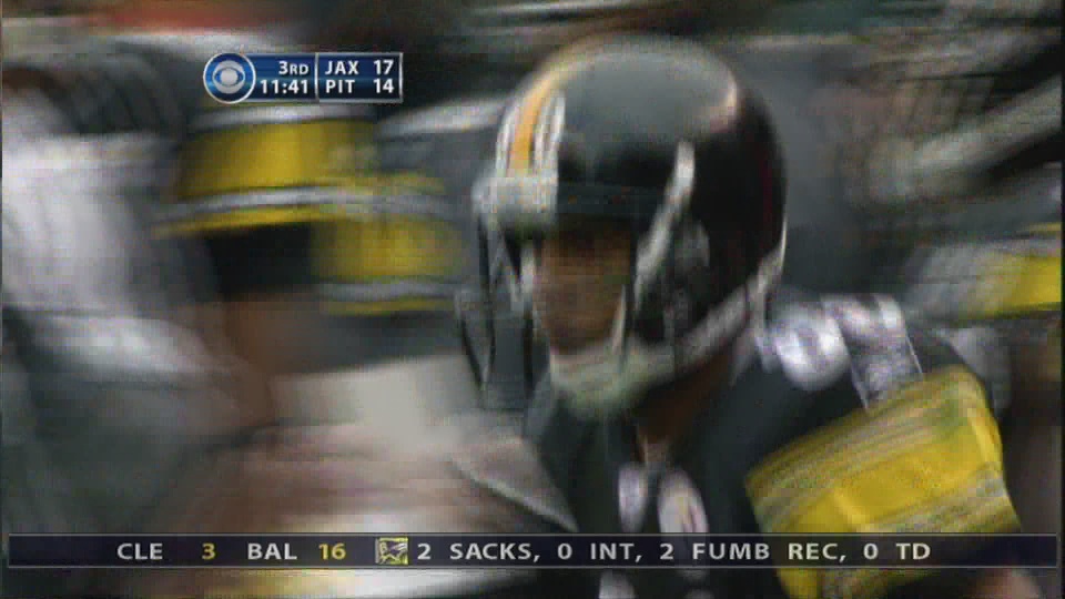

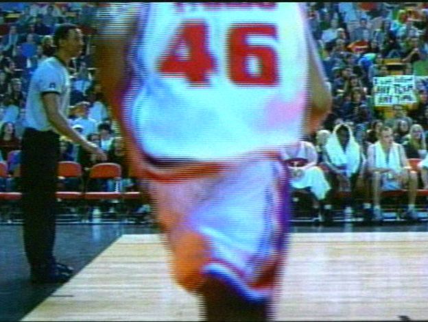

What defect do you see? Is it possible to post a captured frame?
Are you seeing something like this?
or this?
These are examples of different motion distortions caused by deinterlacing.
