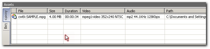

There is a program in the "tools" folder called makesample.exe under where you installed SVCD2DVD... this will enable you to create a sample of the mpeg.
See ya learn something every dayOriginally Posted by ChrissyBoy
http://www.morejammin.com/support/cwtk-SAMPLE.zip -
Do you get the same error with the sample:
?SVCD2DVD v2.5, AVI/MPEG/HDTV/AviSynth/h264->DVD, PAL->NTSC conversion.
Yes same error.
But I see you do not. What could I try or check do you think?
I was not getting this when I had the old version installed, then I uninstalled the new version and installed the old again, with same error.
Any ideas? -
