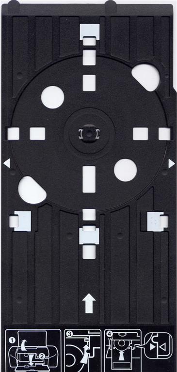

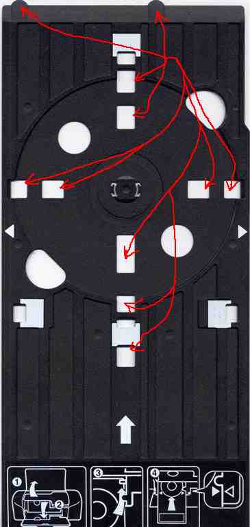

    Are there any differences between the R200 and R220 other than the improved tray?
  12. Banned
    Nov 2005
    i called epson, the print quality, catridges...are the same---it is all cosmetic, except for a much better tray. i too called in for a replacement tray, it was identical to the original. the tray i aquired from the R220 is different--do i need to upload a pic???
  13. Member p_l's Avatar
    Montreal, Canada
    Here's what the replacement tray they sent me looks like:
    Oct 2005
    Australia
    This is what's different to mine:
    All the holes are smaller, and the 2 knobs on top aren't present, instead I have the shitty plastic strip.
    (I have the R210 - though, this shouldn't make a difference surely).
  15. Member p_l's Avatar
    Montreal, Canada
    So you probably still have the original model with the plastic tabs, the one which has caused so many problems.
    Oct 2005
    Australia
    Ok, right, so I got the one that's crapped out on me! Does the new tray fix this?
    Does the new tray work in the R200? I assume the various white marks are used for alignment when the tray does the "Epson Dance" before it starts to print a disc. But can the R200 recognize the pattern on the new caddy?
  18. Member p_l's Avatar
    Montreal, Canada
    My new tray, pictured above, works fine in my R300, which is essentially the same as the R200.
