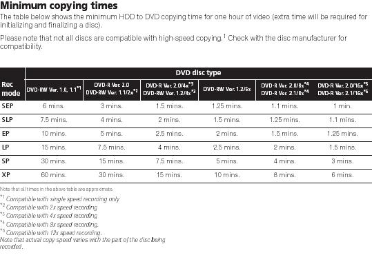

I've used both TDK 16x and Verbatim 16x in the 520, which may be a model slightly older than yours. Possibly another brand or two as well, but those are the ones I recall. I think the Verbatims might be your best bet. (As redwudz said, just the brand might not tell the whole story.) These models only have an 8x burner in them, so faster media is no advantage.Originally Posted by hayabusa
The 8x media is reportedly getting phased out, so if you want 8x, now might be the time to stock up. Chain stores like Staples, Office Depot, and Best Buy are often having specials on 8x spindles. (Perhaps the Mfr.s are dumping their stock of 8x.) Among these occasionally you can find 8x spindles from Sony, Maxell, or Fuji that are Made in Japan, and those are the ones to get. You may have to hunt around for them.
