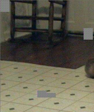

  6. This is what it looks like and it occurs about every other frame. I have a very fast computer. That is not the problem. Other captures are fine, it's just when I capture to DV with WinDV, instead of huffvy avi with VirtualDub.

  7. Member edDV's Avatar
    Mar 2004
    Northern California, USA
    Try WinDV for transfer and see if you have problems. Then import the file into VirtualDub.
    View the file before and after importing to virtualdub.
    A DV codec isn't needed to transfer a stream from the camcorder to the DV-AVI file on the HDD. WinDV uses the MS DV codec to decode DV for viewing only.

  10. Member edDV's Avatar
    Mar 2004
    I haven't seen blocks like that except when heads get dirty. You can rule that out by capturing a raw live camera or pass-through feed over the IEEE-1394 connection.
    Second idea is maybe playback is not working correctly. Try transferring back to the camcorder with WinDV (to a different section of tape) and see if it plays ok from the camcorder. If it does, then the transfers to the HDD and back are OK.
    If not, the problem is probably with backgrond tasks hogging the drive. First turn off all background processes. Next, try to transfer to a separate HDD, ideally with a separate HDD controller from that used by the OS.

  11. I get the same result from a live feed capture (no tape involved).
    I think I isolated it! In WinDV, when I choose type-1 (javs) I get no audio but the video is fine. type-2, I get audio but the video has those blocks.
    What should I do?

  12. Mod Neophyte redwudz's Avatar
    USA
    Kind of backwards, but you could use Type 1, and a Type 1 to Type 2 converter. https://www.videohelp.com/tools?tool=Canopus_DV_File_Converter
    Type one should still have audio. See if it shows after conversion to Type 2. If not, maybe the cable, Firewire card or some internal codec problem with Windows. Or maybe codec interference?
