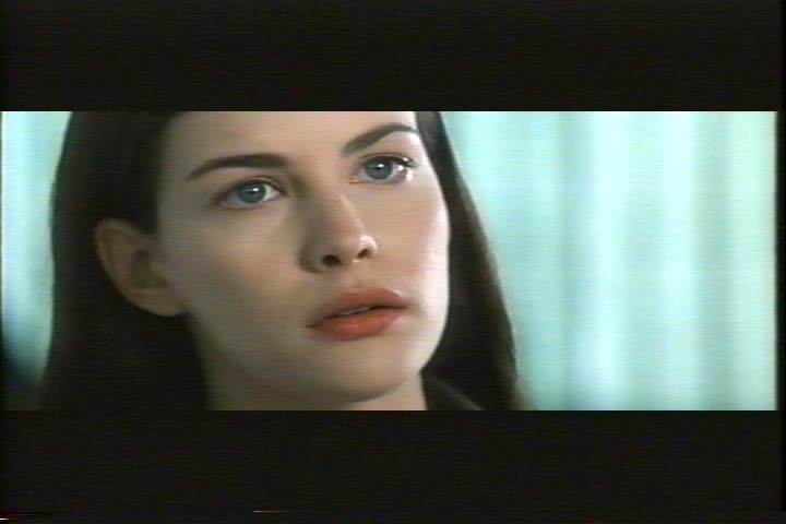

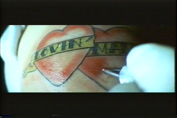

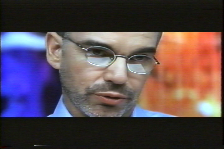

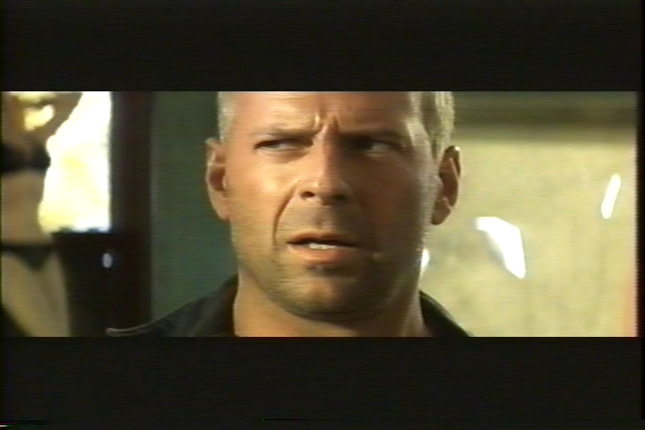

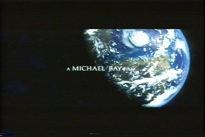

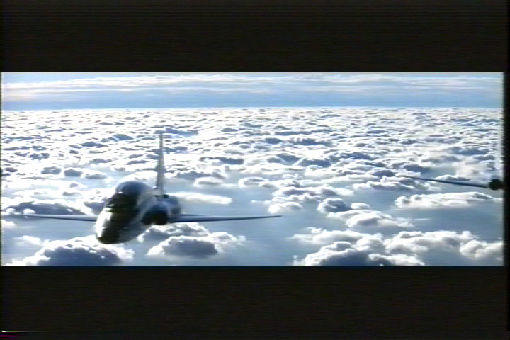

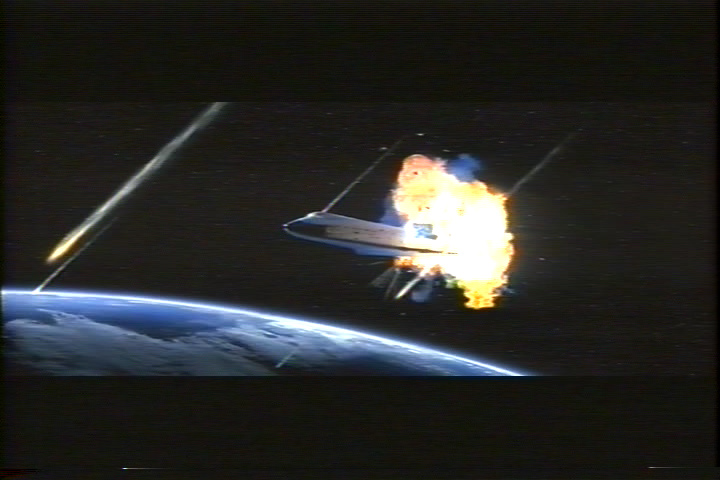

    Here are some screen shots from a commercial (store bought) WideScreen VHS video of the movie ARMAGEDDON ... these pics are from a capture using the ADS Instant DVD 2.0 and are presented in the original capture size of 720x480 using as little JPG compression as possible.
    I tried to copy this same VHS video using my Pioneer stand alone DVD recorder but it wouldn't let me due to copy protection LOL

    You have to realize that there is only so much detail when it comes to a VHS video source. It is never going to look like a studio produced DVD video in quality.
    The ARMAGEDDON images were done without a TBC so using a TBC might very well improve the picture quality in that you will get a more stable image with less issues such as the possibility of less color bleeding etc. and of course for MPEG encoding the more stable the image the easier it is to encode so less MPEG artifacts (although that capture was done at 15,000kbps CBR so there really shouldn't be any MPEG artifacts visible).
    Another thought ... the ADS Instant DVD 2.0 has two different settings for "video noise" reduction. I think the ARMAGEDDON capture was done at the default settings. You could lower the settings for more detail ... but also more video noise.

    I tried to capture the same ARMAGEDDON VHS with the same VCR and cables to a Hauppauge WinTV-PVR 150 and although that capture solution ignores copy protection the image was not stable enough for the Hauppauge (which is touchy with such sources) and recorded a horrible signal. This ARMAGEDDON VHS was bought second hand used and did show some wear and tear here and there so it wasn't as prestine as a VHS tape could hope to be.
