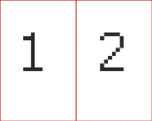

    Originally Posted by Nelson37
    I know AviSynth can do this, have seen the script posted.
    https://www.videohelp.com/forum/userguides/99389.php#crop
    part1=AVISource("D:\part1.avi")
    part2=AVISource("D:\part2.avi")
    StackHorizontal(part1,part2)
    If in doubt, Google it.
