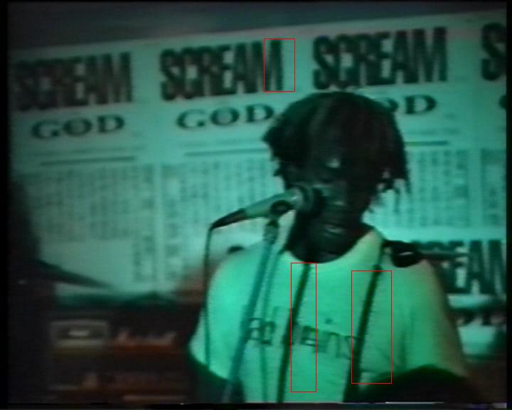

    yes , it is like 7600 units. The video jumps only with the tbc is on. But the "white grains - points" are always staying.
    You can see them in the red squares
    Your tape looks like it was EP mode, or recorded SP with a not-great VCR and not-great tape.
    I can already tell from the pink/green flashing at the top of your tape that this is either a copy of a copy, or a detiorated master. Again, likely caused from a crappy recording VCR and not-great VHS blank.
    It's VHS, it's far from perfect. What you've done so far, in regards to cleaning the image, is about all that can be done.
    The camera work on this is so bad that I can't tell if the tape is jittering, or the camera was. I'd have to see either a much longer clip, or a still shot where there was sudden movement.

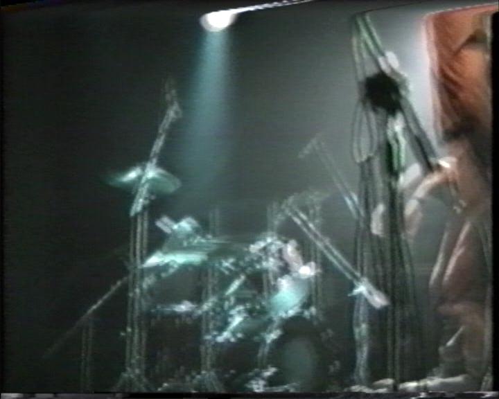

    Well , it was not what I hoped... It removes the jumping very well , and now my card doesn't drop frames...... but.....
    I thought that it would clean the picture (like in the box it says) but not... the picture is the same , the tbc/dnr button of the jvc does the major job , clean the chroma noise.
    I don't know really what the tbc does but why it can't correct this?

    This is field blend... Nothing much you can do about it.
    TBC keep the field 29.97 / 25 per second and when something missing, "fix" it (very raff explanation).
