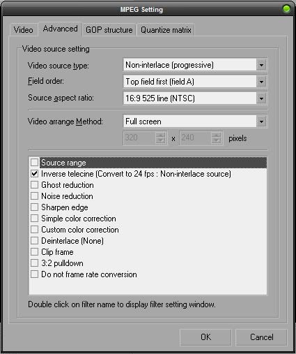

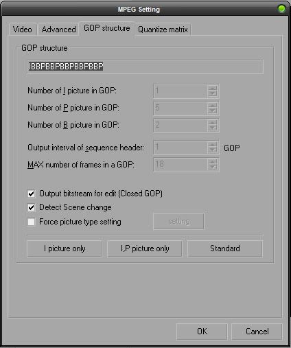

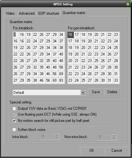

    I am so frustrated right now... Well about a week ago I converted an HDTV .avi into an .mp2 and burned it to a DVD with AC3 audio. It looks perfect and sounds great. I used TMPGenc to encode the video portion. Now I am trying to do the same thing again, however when I try to encode through TMPGenc, it takes about twice as long and there is a "sticky" frame about once every 20-30 seconds. I cannot for the life of me figure out why it is taking so long and there is that annoying sticky frame. If anyone could help me I would REALLY REALLY appreciate it. I know for a fact that the first time around I encoded at 8000 kbps, VBR (2-pass), so I don't think that this is the issue. Here are pictures of the settings I am using to encode the .avi:

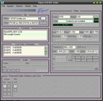

    Here is a picture of the GSPOT screen for the original .avi:

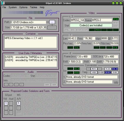

    Here is a picture of the GSPOT screen for the encoded .mp2:

    The HDTV AVI is 23.976fps so it is already progressive yet in your TMGPEnc setting you have the INVERSE TELECINE option enabled. Wrong! That is when you have a source that is 29.970fps and you are trying to make it 23.976fps ... but your source is already 23.976fps.
    Your settings seem OK so really just deselect the Inverse Telecine option. Do not check mark the 3:2 option on that same screen. You have it set correctly already on the "video" tab.

    ** Video TAB -> frame rate: [23.976 fps (internally 29.970 fps) ]
    ** Video TAB -> Encode Mode: [3:2 pulldown.. ]
    ** Advanced TAB -> [ ] Inverse Telecine
    ** Quantize TAB -> [x] use float..

    The [x] use float.. was ghosted, but not truely set. Its the same
    as turning it off, but limited speed. Turning it on will increase
    the speed - or should.
