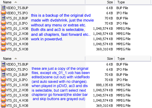

    hi, i have authored a movie(consisting of 5 vobs) with no menu using dvdauthor, and when i play it in powerdvd the option for dts audio is gone(ac3 is still there) and there's no chapters(the slider is grayed out).
    I did edit the first VOB with videoReDo(cut out a scene and did an autosave).
    I tried just putting the edited vob back with a copy of the original 4vobs and ifo's, the dts option worked, but no chapters(and grayed out slider).
    anyway i can get both the chapters and DTS option to work with either authoring or just putting the VOB back with the original files
    thanks for any help

    sorry if i didnt explain it properly, these are the two video_ts folders im working with:
    If i author with tmpgenc dvd author, then both the chapters and DTS options, are gone.

  7. AFAIK dvdshrink also has (quite limited!) editing possibilities. Maybe you can cut out your scene there while keeping dts and chapters intact.
    Yep: Use the reauthor option. It let's you keep the chapters and any audio/subtitles you want.

  8. still slow bigMach™'s Avatar
    Nov 2005
    village of PAL
    WOW! i just tested it now using dvdshrink and it does cut, and save with chapters and both ac3 and dts streams......if only i did this in the first place
    But! i seem to be only able to cut one bit out of the movie, not at two different parts of the movie. unless i add the title twice and cut again etc...
    but when i play the movie there is now two titles instead of one, and even though there is chapters, i cant forward to the next title....i hope you can understand what i mean
    THANKS again borax, dvd3500.

    Im sure videoRedo doesnt touch the audio streams, i also just tried mpeg video wizard, and it seems to be similar to videoRedo.
    So, maybe the only way is to edit IFO's, but this is where i get confused
    What would be the most simple way to edit the ifo's so that it thinks the edited VOB is the real Vob. I know you both suggested programs, but how exactly would i go about it in my situation, as ive read guides, but they are general explanations, and im too new to apply it to my problem.
    hope im not troubling any of you, sorry
