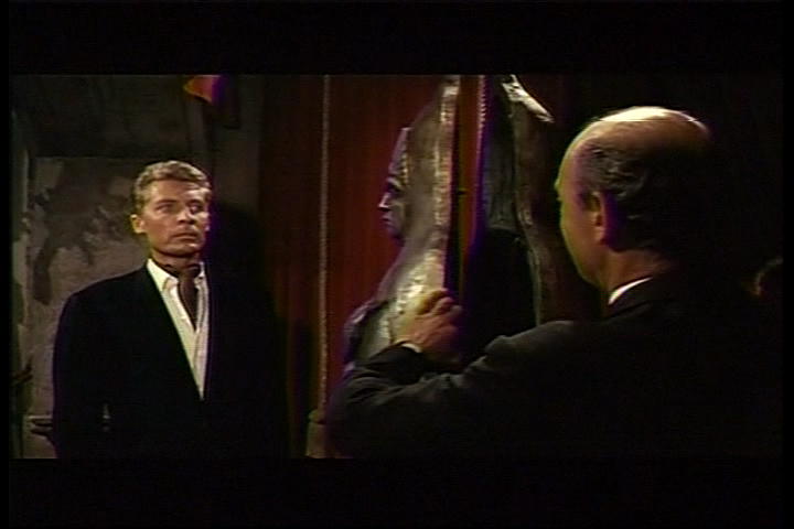

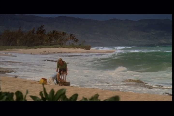

In fact here are some screen grabs of recordings done with the Pioneer DVR-531H-s
All of these are "native" 720x480 (no resizing was done). I used VirtualDubMod to load the VOB files. The image was captured to the clipboard then to Photoshop then saved using PhotoShop's SAVE FOR WEB JPEG function. I tried to use the least amount of JPG compression possible.
Please note that analog cable channels are done from a cable feed that is connected directly to the Pioneer DVR-531H-s via the RF connector. The digital channels are from the Comcast DVR box using composite video. I tried to test a commercial VHS but it had copy protection and I don't (as of yet) have a Full Frame TBC so no go on VHS for now. Actually I have done some VHS but only a couple of super rare stuff. Turned out really good but both are multi-gen tapes that didn't look that good to begin with so I'm not incluidng those screen shots.

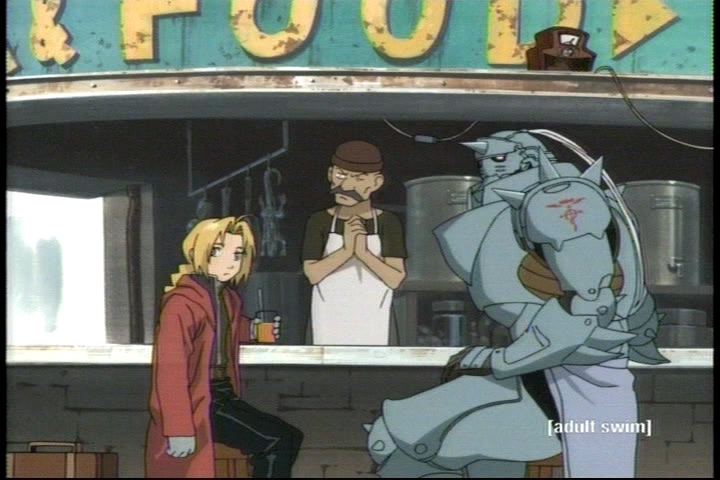

FULL METAL ALCHEMIST
Cartoon Network - Analog Cable Channel (SP Mode)

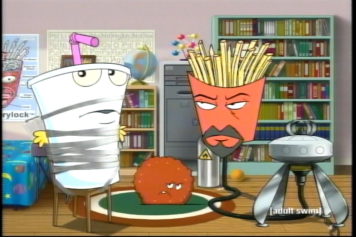

AQUA TEAN HUNGER FORCE

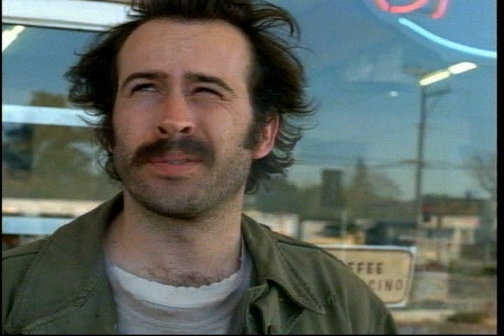

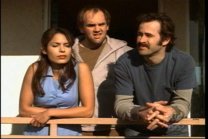

MY NAME IS EARL
NBC - Analog Cable Channel (SP Mode)
MY NAME IS EARL

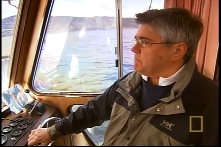

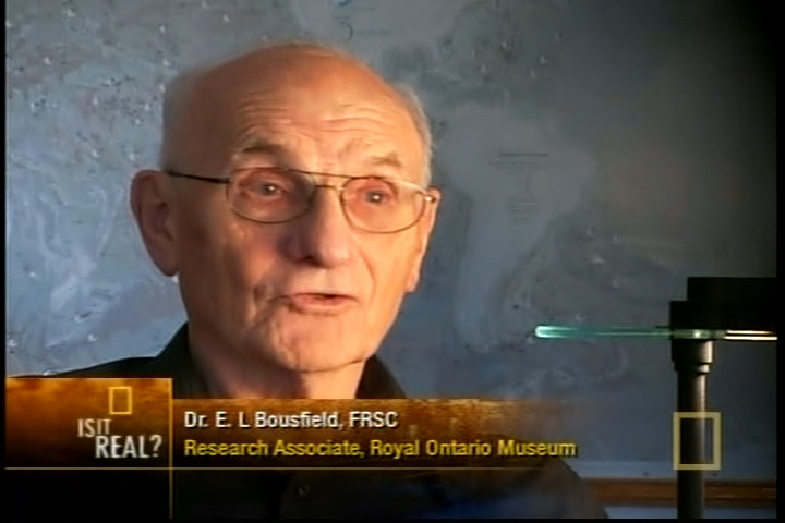

IS IT REAL? - MONSTERS OF THE DEEP
National Geographic Documentary - Digital Cable Channel (SP Mode)

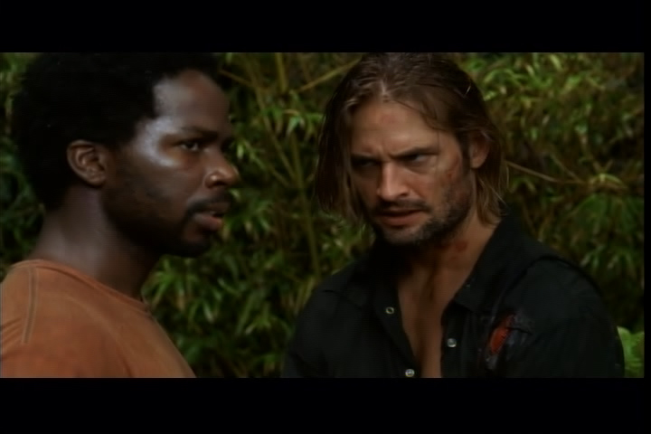

LOST
ABC - Digital HDTV Cable Channel 480i 4:3 WS Output (90 Minute Mode)
LOST

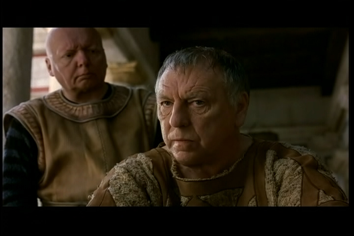

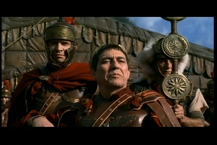

ROME
HBO - Digital HDTV Cable Channel 480i 4:3 WS Output (SP Mode I think)
ROME

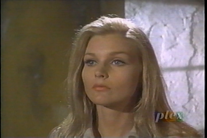

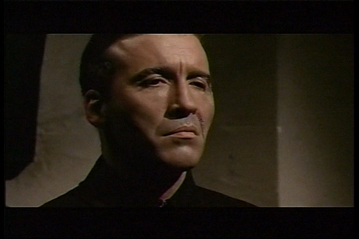

These last two are from TCM (Turner Classic Movies) which is an analog cable channel on my cable system. This is from a very rare movie that recently was aired on TCM for the first time this past October 2005 so the quality is NOT as good as you might expect but then again that is the point I suppose. This was done at the 1 hour 25 minute mode as the movie was 84 minutes (and boy it did JUST fit).
As you can see the Pioneer does a most excellent job when the source quality is very good. For channels with a lot of noise (like MY NAME IS EARL) or when the source is not that great looking (the TCM shots at the end) you kinda get what you put in i.e., garbage in ... garbage out. I guess the important thing to note is that it doesn't make a poor source look worse BUT it doesn't really improve it. I would like to try a JVC with that LSI chipset sometime to see how it does as it apparently deals well with "video noise".

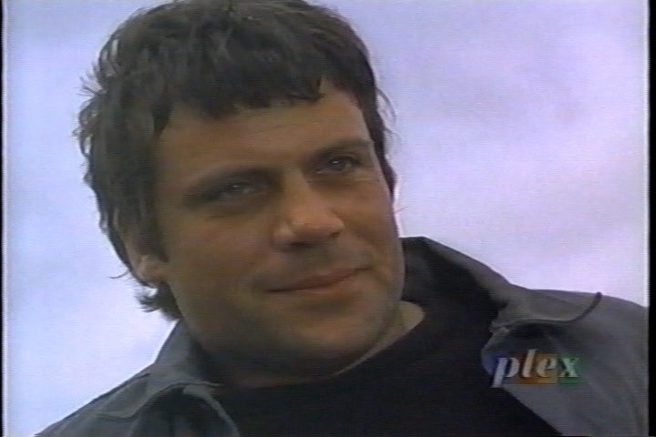

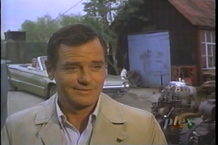

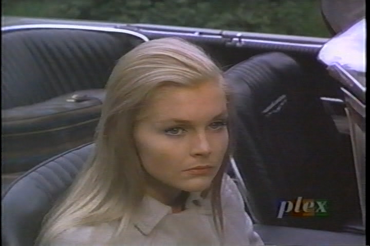

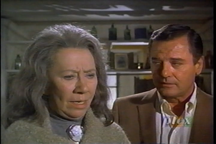

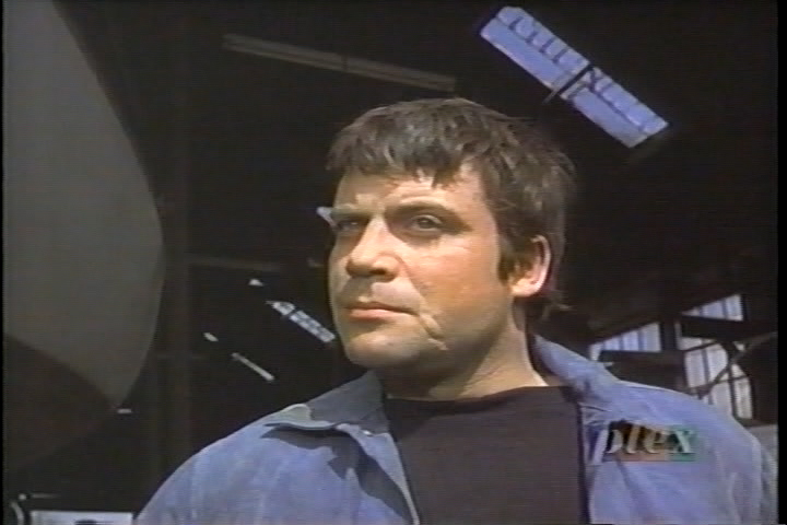

OK I did some VHS captures as well.
The follow is THE SHUTTERED ROOM
The source was cable TV to a Panasonic 4 Head Mono VHS VCR and the recording was done at SP speed. I think this is from the mid 1980's but not sure (it is a tape from a friend who wanted it on DVD apparently this is a very rare movie).
This VHS was played back on a Toshiba 4 Head Hi-Fi Stereo VHS VCR with the V3 Pro Drum (they don't make them like this anymore unfortuately).
The VHS to DVD recording was done with the Pioneer DVR-531H-s using the XP+ mode ... I used accurate editing to trim the start and end and a short 10 second sequence where my idiot friend hit the channel button on his remote by accident (missing 10 seconds of the movie for the cable guide channel oh joy). This was a commercial free showing of the movie so that was all the editing that was needed. I then used the OPTIMISE fuction to put it on a DVD-RW. The final movie after editing is almost exactly 1 hour 40 minutes. I then re-authored on the computer with TMPGEnc DVD Author (no re-encoding was done at that point) to create a final DVD-R disc. These images come directly from those VOB files using VirtualDubMod and Photoshop. These are the original 720x480 images compressed (as little as possible) into JPEG format.
Between the VHS VCR and the Pioneer DVD recorder I used a VIDICRAFT AVP-100 which is a simple PROC AMP ... I used it's built-in audio DNR (which worked wonders) and tried to sharpen the image a bit (but not much). I think I upped the LUMINANCE just a tiny bit as well as the color (again increased by a hair's breath).
This is not a great quality source but the only VHS I have done to date with the Pioneer other than a poor looking PAL to NTSC VHS of DARKER THAN AMBER which turned out looking OK but had that odd PAL to NTSC look to it ... damn I wish I had the original PAL VHS instead of a NTSC VHS copy but DARKER THAN AMBER is even more rare than THE SHUTTERED ROOM.
Here are the pics:
I hope this gives you some idea of the PQ of the Pioneer DVR-531H-s
