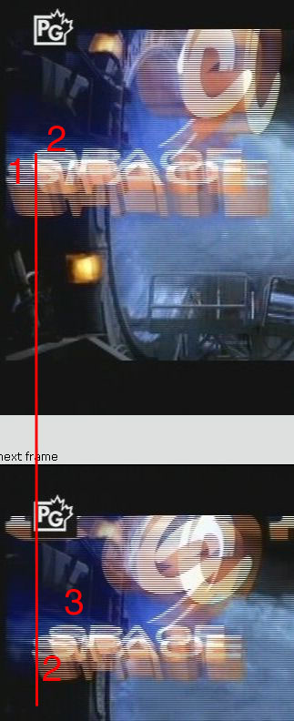

    first frame
    next frame
    after deinterlace
    if you use pageUP/pageDown you can see between the first two frames there's one complete progressive frame if you use odd fields from one frame and even fields from the next.
    As you can see the final image shows one complete image without blurring or missing picture resolution or temporal resolution.
    And since reducing the fps to 23.976 did get rid of useful frames I don't see why what I'm doing is such a bad idea.

    I see one field from the first frame.
    What do you see?
    This is an animated overlay over some kind of non-moving video. Motion is extreme but motion resolution is low.

  10. I'm seeing two fields in each of the first two frames.

    I'm seeing 3 fields over 2 frames. Maybe 2a and 2b make a frame but the time sample is at the same point.

    the background is in motion also. the big blue thing in the middle is moving towards the right. It's not part of the overlay.
    I'll try to explain this better.
    The first two frames are before deinterlacing.
    The first frame is composed of two fields, let's call them f1, and f2. These two fields are from two points in time, let's call them t1 and t2.
    The next frame also has two fields, f3 and f4.
    f3 takes place at point in time t2 and f4 takes place at another point in time, let's call it t3.
    So to summarize f2 and f3 take place at the same point in time so they can be put together to form one progressive frame, which is the result in picture number 3.

    But you need to see this over at least 6 frames to see if the original elements were 29.97 interlaced, 29.97 progressive or 23.9 progressive.
    It should be noted that title sequences are often at different frame rates than the main show.
