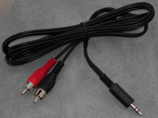

Normally the red and white would be the audio in or out and the yellow the video. Some video capture cards don't have an audio in, but use the sound card input for audio in.
You can use a Stereo RCA Phono to a stereo 1/8" phone plug adapter going into the blue line in connector on your sound card. It's a fairly common adapter, found at most audio stores. The pink is microphone and the green is speaker out.
Or if your card does have audio in, it would be the red and white connectors. And as mentioned, you will probably have to activate that in 'Control panel>Sounds and Audio Devices'. -

But for VCR or other video and audio input, you would plug your VCR sound out into the blue line in on your sound card with a adapter similar to this:

I just wanted to say a bit THANKS to everyone here, i've finally gotten it working (I think) I needed a miniplug to miniplug from my audio out into my blue connection on the back of my PC.
