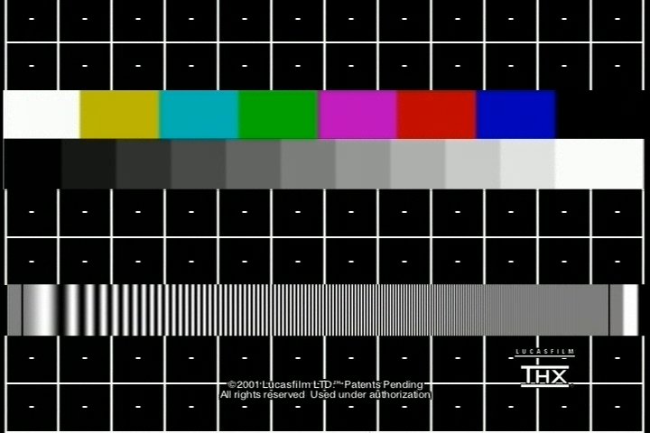

Here is an image with IRE 7.5 for a source with IRE 7.5.

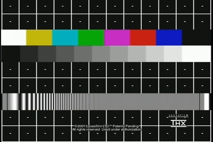

Here is an image with IRE 0 for a source with IRE 7.5.
