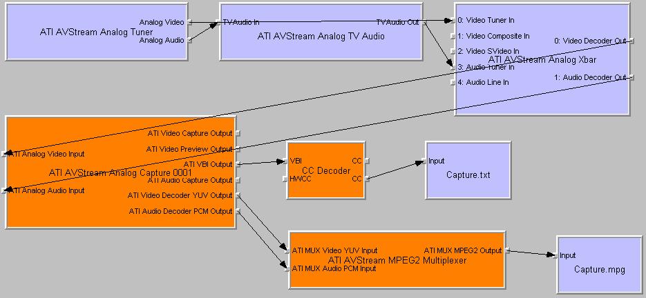

I can help you with with the closed caption thing though...
the "capture.txt" and "capture.mpg" are DirectShow dump filters. If you can't find the Dump filter under DirectShow, then goto
http://nickyguides.digital-digest.com/audio-extract.htm
to find out how to install it. -

I used McPoodles sample graph and kept getting an error similar to yours, indicating an attempt to use something already in use.

Yeah, I got the error using mcpoodles graph too. Remove the preview and it should work.
