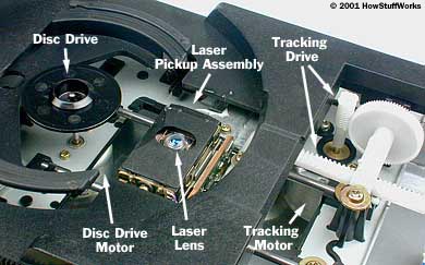

    Good Post and Photo
    I have always felt that removal of the top cover and repeated cleaning of the Laser is unnecessary and anyone attempting to do so should be aware that they can get it out of alignment and compound a proplem.

  6. Mod Neophyte redwudz's Avatar
    USA
    I agree about cleaning..... Only when you have to.
    That said, some users have problems with smoke and dust, and cleaning is the only choice to restore use. I look at it this way, If it doesn't work and the alternative is replacing the drive, you have little to lose by cleaning.
    I use 'canned air' air first to see if that helps, if not, go ahead and try cleaning. Use a damp foam Q-tip type of cleaner. This avoids the cotton fibers of a regular Q-tip. I use denatured alcohol; Isopropyl is OK if you use 99% solution. Regular rubbing alcohol has too much water. Don't drench it, just carefully remove the gunk from the laser lens. Be gentle, don't shove the slide around or wash off the slide lube. BTW, that photo is a CD drive, but a DVD is similar.
