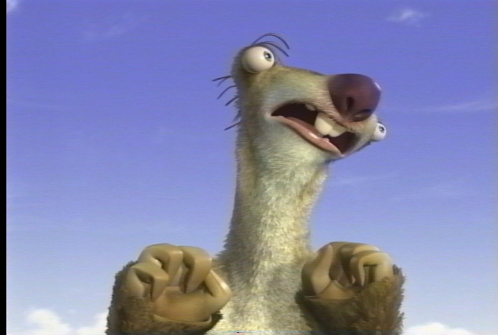

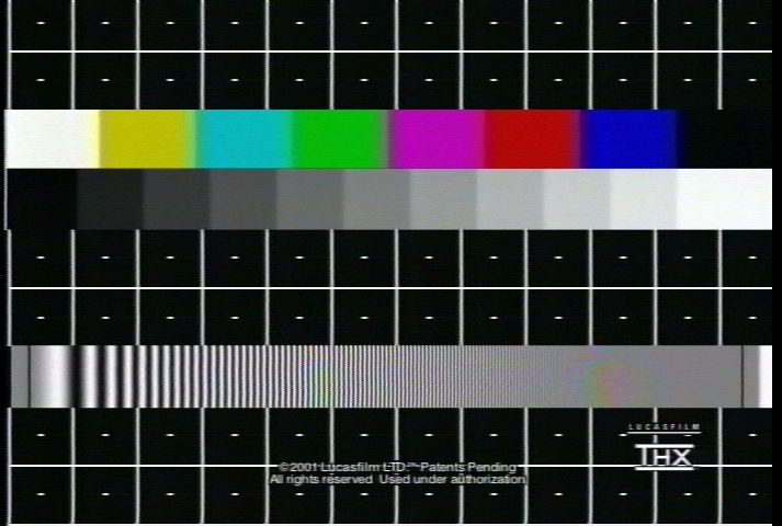

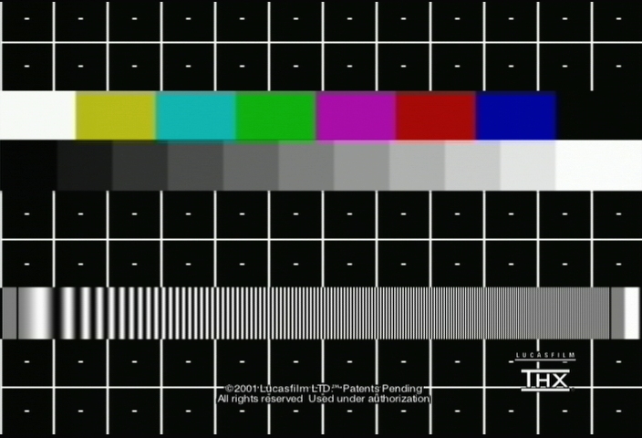

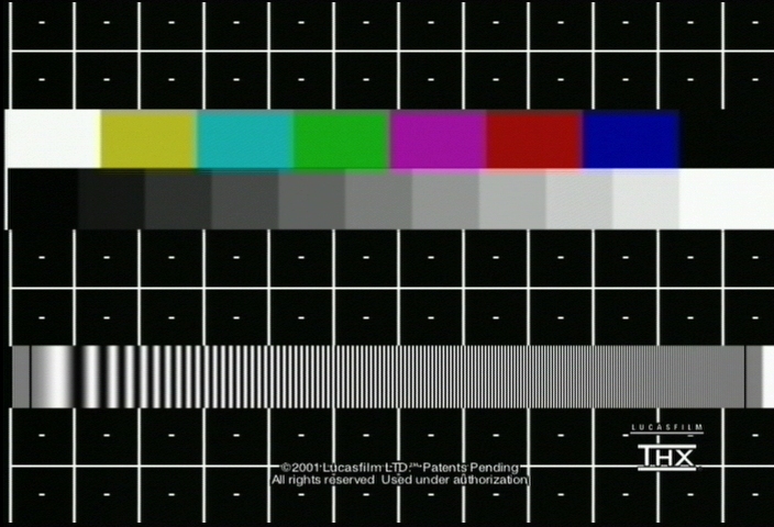

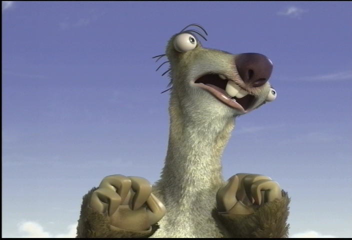

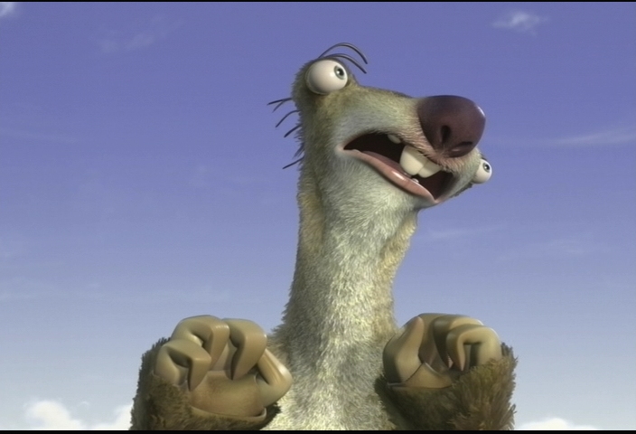

Ice Age Test Pattern with no TBC
Ice Age Test Pattern passing through Datavideo TBC-3000

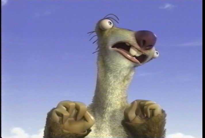

Ice Age sloth with no TBC
Ice Age sloth passing through Datavideo TBC-3000

Your pics demonstrate how DataVideo TBCs soften the image; hardly 4:2:2 performance.
Was this the S-Video path?
It would be helpful to also show the Composite path...or perhaps Composite in / S-Video out... -
@vhelp - interesting little analysis. I hope we can get enough interest going to get folks to make the effort to do this. BTW, you are correct about the shifting of the picture, at least as far as the TBC-3000 goes. About 10 pixels or so to the right as I recall.
@davideck - yes, this was the s-video path. I didn't try the composite path (although I assume that would be interesting to those who have to use the composite path). I also didn't try any transcoding. Maybe tomorrow/this weekend sometime. -

I honestly can't tell any difference in the ICE AGE image other than the slight shift (extra bit of black on the left hand side of the TBC image). Detail wise I see no difference.
As for the THX pattern ... I do see a very little tiny bit of detail lost due on the far right of the "line" test pattern (whatever you call it). The one near the bottom with all the lines that get closer and closer as you move from left to right. I do see a loss of detail as you get to the far right.
However that seems rather subtle to me. Even the very small lettering at the bottom of that screen (LucasFilm above the THX and the legal stuff text) looks the same to me with or without the TBC.

There does appear to be some very slight softening in the TBC pass through frame grabs, but they are otherwise excellent images with no artifacts... nice and clean. Looks good to me!
the thing i notice is with the tbc in line the blue cloud line running behind his head shows more blue however the clowd wisps below the blue line just to the left of his head are almost gone. both are good images but i do like the one without the tbc more.

JPEG or no JPEG, BrainStorm69's THX Test Pattern pics accurately represent the loss of detail that occurs through a DataVideo TBC. I have verified this on a TBC-1000 (which is based on the TBC-100 board) and on both channels of a TBC-3000.Originally Posted by lordsmurf

To all - while I appreciate the in-depth analysis and commentary on my one example, the point here is to try and get examples from as many different TBCs as possible and compare the output of various TBCs.
So please folks with other TBCs, do some capturing and post the results for comparison.

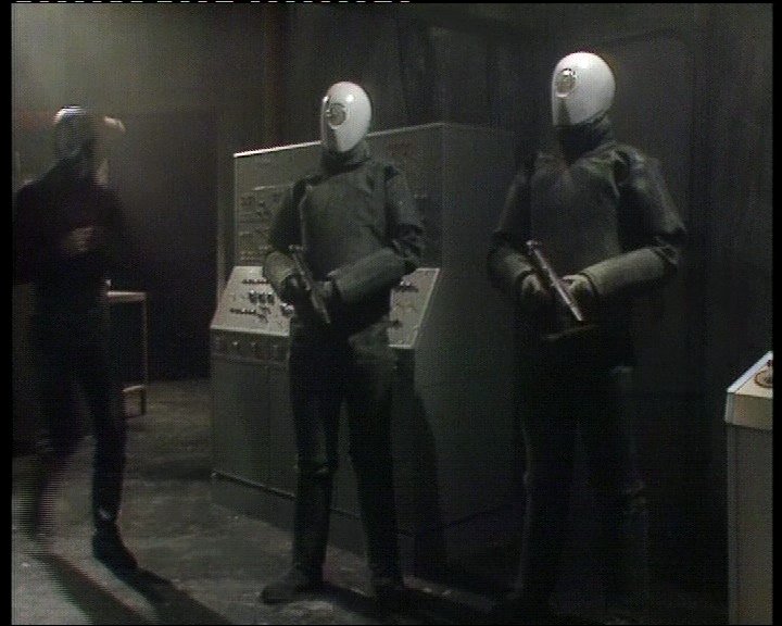

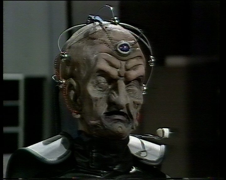

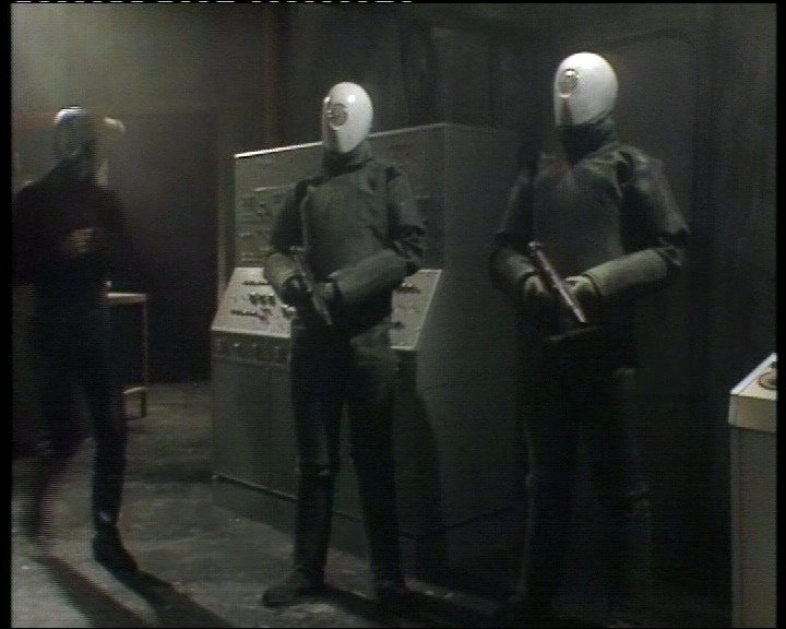

Okay, seeing as I have only just got my TBC, I'll have a go:
Both captured via composite connections (to an ADVC-50) and source is in PAL.
Without TBC
With Datavideo TBC-100
On close inspection, in the picture with the TBC, there is definitely a softening of the picture and a slight washing out of the colours. There doesn't appear to be any shift to the left or right of the frame though.
The souce material was a DVD of a BBC TV production from 1984 (no prizes for guessing!) which is why the image is not particularly clean, but it still shows the difference.Cole -

In Cole's latest pics w/ and w/out a TBC-100, I can see two things:
** orig pic has sharper detail and is color same
** but, tbc pic has less detail (smoother pixels) and color is lighter
(I used an old tool I created for this sort of test, and I was able to
spot such things quickly)

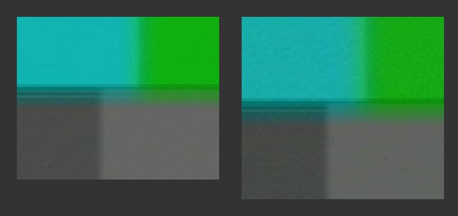

@Cole - thanks for contributing! There is a definite softening of the picture through the TBC-100. Seems like more than through my TBC-3000. But you are also using composite connections and this is PAL vs NTSC. Hmmmm...wonder if I ought to try my examples again through the composite connections. Also, I determined the shift for the TBC-3000 is 9 pixels to the right.
@Vhelp - interesting that you theorized that PAL video wouldn't shift. But you don't remember why? Too bad, because I'm certainly curious.
@All - just for completness of information, I captured my examples above using my AverMedia DVD EZMaker using Virtual VCR with HuffyUV codec. Screen caps came straight from the AVIs using VdubMod in .TGA format. Then converted to .JPG using PaintShopPro quality setting 1 (least compression). -
This is an interesting experiment, but I now feel that I will need to adjust the colour slightly during my VHS encoding.
My stills above were captured using WinDV, the screen caps taken using Virtualdubmod and saved as .jpeg (but not using any further compression) using Paint Shop Pro 7.

I got to thinking about the comment made by SLK001 about using a DVD for the source (which does not need time base correction) instead of a tape (which does).
My original thought process was as davideck said, to use as clean a source as possible. But then I got to thinking about the softening of the picture by the TBC-3000, and I remembered something I read about one of my other devices, the SIMA SCC - a point was made about it having 525 scan lines.
I got to thinking that perhaps the softening my original images showed was due to the fact that TBCs, being intended for mediums that need time base correction, would not be designed to deal with DVD resolution.
So I taped the Ice Age test stuff to S-VHS tape and did the captures again. Guess what? No more softening of the image by the TBC. Look at the frequency sweep on the test patttern cap - looks the same to me. But is still evident that the TBC introduces noise into the capture if you look at the color bars.
See for yourself. I added some borders to these to correct for the picture shifting of the TBC and make it easy to flip back and forth for comparison.

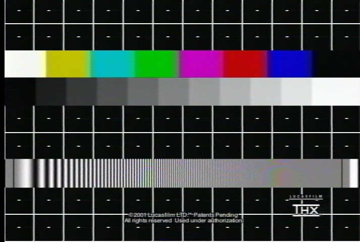

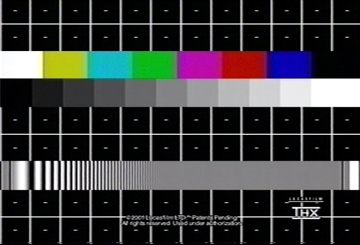

Ice Age Test Pattern - No TBC
Ice Age Test Pattern - with TBC
Ice Age sloth - no TBC
Ice Age sloth - with TBC -

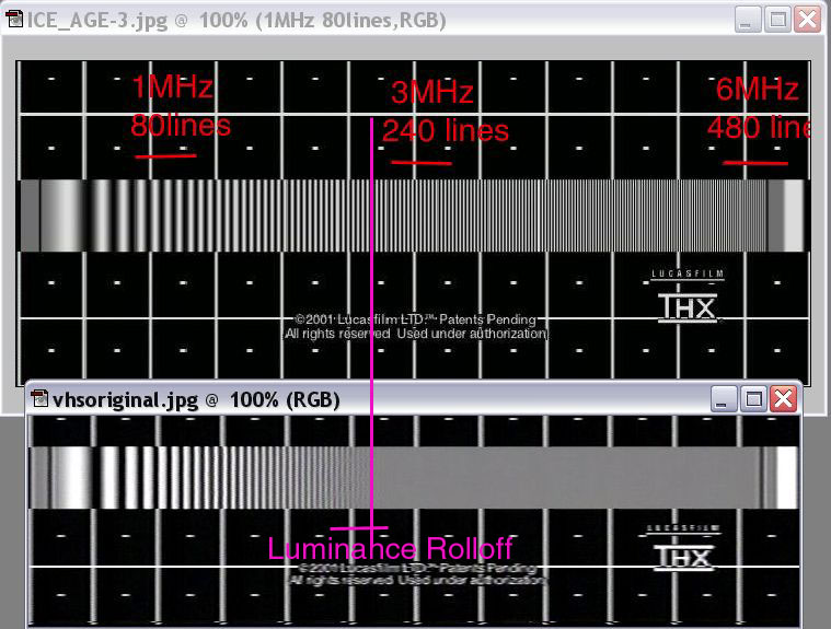

Was this an S-VHS recording/playback using only the S-Video path?Originally Posted by BrainStorm69
The frequency content of this source looks well below S-VHS capability (400 lines), and the chroma artifacts in the frequency sweep suggests a composite mix somewhere... -
I have a JVC 9800 with a Built in TBC, does this count as a TBC. Would it be redundant to get a standalone TBC like the datavideo. Also what would be the result of passing video thought 2 TBCs?
Of course. Recording to SVHS has stripped away all the high frequency content. There is none left for the TBC to lose.Originally Posted by BrainStorm69
Yes, it was all using the S-Video path. The chroma artifacts confused me a bit, too.Originally Posted by davideck
Agreed that the TBC can't lose what wasn't there, but the point is that it isn't losing causing any loss of detail in those situations we would be using it - when correcting time base errors in video tape. I'd heard some people say that they don't like one TBC or the other because it "softens" the image when capturing video tape. I would have to say that any perceived "softening" in the case of the TBC-3000 is not actual loss of detail. Perhaps it's chroma issues of some sort causing the perception of loss of detail, or perhaps folks are just wrong.Originally Posted by junkmalle -
davideck,
In this thread,
https://www.videohelp.com/forum/viewtopic.php?t=239205
I copied same ICE AGE pattern from a dvd player to a standard VHS recorder, then captured the VHS playback with a Panasonic ES10 dvd recorder. Here is what it looks like.
edDV did this analysis of frequency response indicating it is about right for standard VHS.
Still a softening up of the picture, sad to say.
I am acutally quite disapointed with the TBC-100 in this respect as I had invested quite a lot of time and effort to improve my VHS to DVD captures. The TBC-100 was purchased to deal with a syncronization issues with the capture card, only to have a detrimental effect on my final captures.
What does anyone think about this?Cole -
For as much as people have insisted VHS is a format that separately records luma and chroma, it really does give off the appearance that it's a composite "merged" signal. Or at very least, a sloppy separation that bleeds into one another. It takes a good VCR with a nice Y/C comb filter, maybe even a line TBC with some DNR, to prevent messy stuff like shown in the images.Originally Posted by BrainStorm69
I think if it's that noticeable, you should buy a detailer and insert it after the TBC. It'll be good for not only counteracting what you think is softer there, but it can even surpass the sharpness of the source.Originally Posted by Cole
What people seem to forget is that by the time you encode this to an MPEG, and view it on a normal tv set (or even something larger and/or fancier), at a normal viewable size, all of the talks of lost detail pretty much become moot. This sort of "lab test" on a small computer screen with test patterns is already at the point of being either imagination, or so minute that it doesn't get notice by at least half of the people involved.Want my help? Ask here! (not via PM!)
