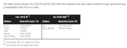

For example, the Pioneer DVR-533H shows as being tested with this media,
i guess i am now on the right track. The Pioneer has been tested with the Sony discs. So since i now have that info all i have to do is go find the sony discs at the store and look at the manufacturers ID on them and that disc should work .... right? and by the way where is the manufacturers ID located on the discs? i might be dumb but i aint stupid ! lol

Download freeware DVDInfoPro. Plop the disk in and the software will show the media ID.
http://www.dvdinfopro.com/index.php -
