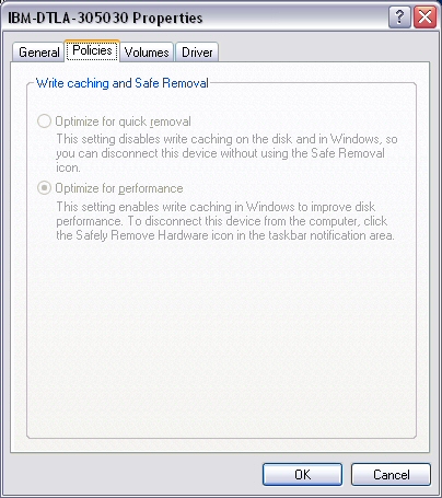

Just like my last drive, I've been getting the "Delayed Write Failed" message and then I can't access the drive. I have to turn it off then on again. This is why I bough a new drive, I thought the old one was toast. Just wondering if this might be a mobo issue? I checked out what ms had to say about it
http://support.microsoft.com/?kbid=330174&sd=RMVP
but I can't understand how to do the first part (In the BIOS, not sure what to look for) and as for the
...it won't let me...not sure what to do now.Turn off the "Enable write caching on the disk" feature:Smile

Plug in the USB device.Originally Posted by beavereater
Go to My Computer and locate the device.
Right-click and select properties.
In the properties window, select hardware.
Select the USB device again, and click the properties button.
You will now have a properties window for the USB device.
Select the Policies tab, and set it to "Optimize for quick removal".
That will disable write caching. -
It will not let me disable it. It is left look like this
Anyway, I don't have firewire on this drive. I never used firewire and didn't think there would be much of an advantage. I guess I was wrong. I just want this thing to work so I can clear up my internal drive.Smile
