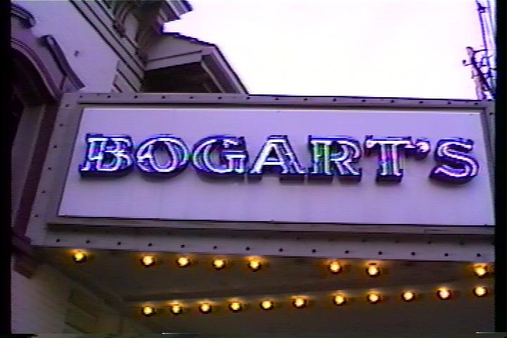

    If you can't see it on the TV it's the overscan area, it's normal. It can appear anywhere around the edges of VHS footage. It can also appear on footage captured from a TVBroadcast. Here's an example:

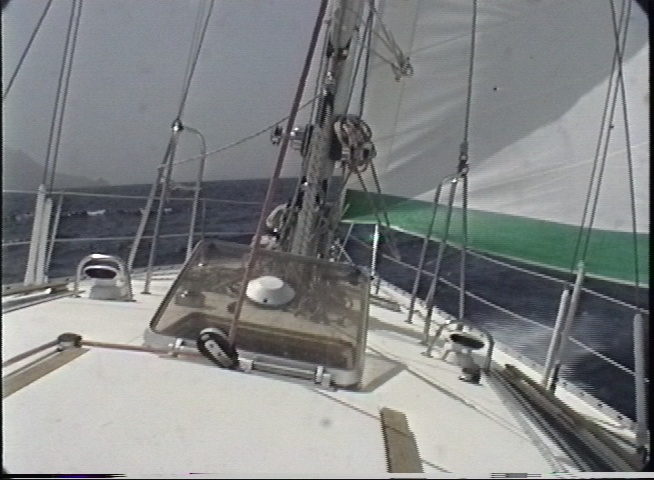

    I think you missed the point. That is what comes off tape. In the good old days, all the edge stuff was masked by TV overscan. It still is but if you view the "underscan" view that engineers used to look at on your computer, you see the edge stuff. Note that you can also see my UV filter cropping the corners on this 14 yr old tape made on my Sony CCD-V5000. It looks fine on my HDTV monitor.
    Masking it out has other disadvantages. For "archive" you get the file as it is warts and all. It will continue to play fine on a TV because for analog inputs, they continue to overscan.
