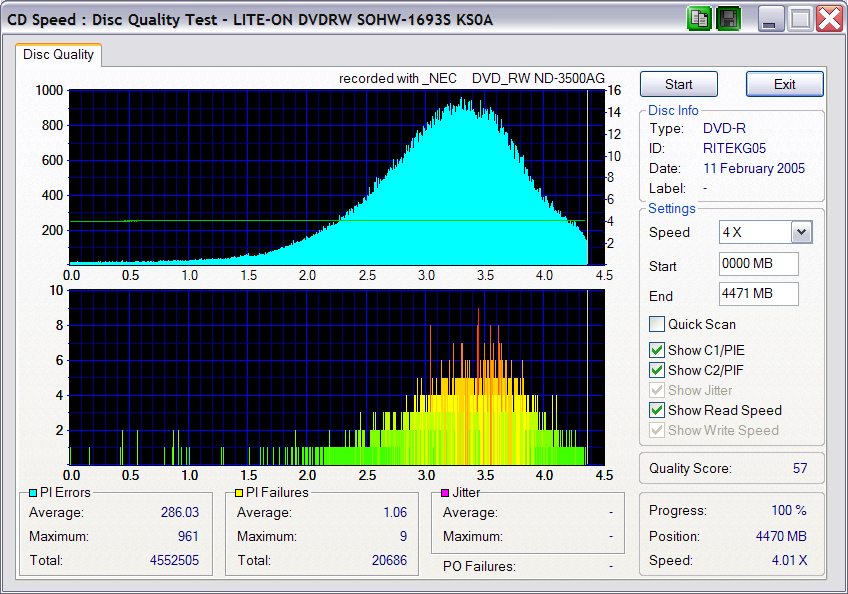

RITEK ramped up production and lowered QC a bit during the G04 lines. The media is not all that good compared to something like MCC or TY. But it's still in the top third or so of all media made. Most people are alright with it, but beware of coasters. The media is not to be trusted, you must test it.
I find no reason at all to consider any Ritek media anymore. The scan below was a very good burn with no bad peaks. It had a very low total error count when it was burned. This is what it looked like after 3 months. It is unreadable today and is reported as "no disc". I had 100 G05s burned on a wide range of burners and they all tanked. Unfortunately, testing did me no good as they all looked fine after the burn. Over at CDfreaks, quite a few users have reported the same problems.

That is exactly the problem with Ritek and Ridata. Sometimes they are fine and sometimes they are trash. All my R03s are fine and all my G05s from a year ago are fine. Lots of people have had no trouble with any Ritek they own. None of that helped any of us who got caught with the bad stuff.Originally Posted by GullyFoyleStill a few bugs in the system...
Doesn't matter how many you've burned, the fact is that the quality of Ritek media has went downhill. I'm in the process of reburning some of my more valuable video/data that I burned on Ritek media in the last 6 months or so because I simply can't trust their media anymore, and I value my data.
If you choose to trust your data with Ritek media, then that's your choice, just don't come here crying that you can't read those discs 6 months from now. -

Nope, that was the problem with the G04s that went bad. These were good old silver Ritek G05s from Newegg.com.Originally Posted by joeg04Still a few bugs in the system...
Welcome to the real world ! If you had read posts over the past year you would know that Riteks have gone downhill. As far as I'm concerned they are downright crap. Only about half of Riteks that I recorded circa 18 months ago will actually get to the end. Forget wether they're red-wraps, green-wraps, or whatever. And its no point saying they will improve, or quality control will be improved etc, cos once crap and your confidence is lost in a product, then its always crap as far as I'm concerned. That goes for anything beginning with Ri....Originally Posted by warrior

You can certainly believe what you want.Originally Posted by joeg04
These were stored on floppy plastic hangers, vertically under no stress at all, in a dark cool low humid place. I have done this before.
No other media has shown any problems including some rare "good" G04. None of these have labels or printable surfaces. They all had the Ridata brand. ALL the discs from this batch showed significant deterioration as show above in the scan. Many of these were scanned right after burning and the scans were very good with PIE levels in the 20s and PIF in the 2s and low total numbers. These discs were burned on seven different drives.
I am not the only one reporting this problem. Over at CDFreaks there were over a dozen posters with the same problems and more people found this was also true after they tried re-scanning.
I also had a few die hard sceptics there as well who insisted this could not happen because it had not happened to their discs. That is why this is so nasty, because there doesn't seem to be a clear pattern as to which Ritek discs were hit with this flaw. Even officials at Ritek have been lamenting the release of large amounts of G05 that are bad, although this problem is not mentioned.
The thing I find so unbelievable is how Ritek users will argue with anyone who "attacks" their choice of media. I mean guys, it is only a disc! This is not some family business your relatives have worked at for hundreds of years. They nailed us with G04 printables and again with the "landscape" discs; again with G05 and reports of tons of B Grade media, and still people attack any reports of problems.
