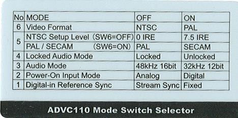

    Macrovision issues aside they are practically identical, the 110 doesn't require an external power supply if you intend on hooking it up to a 6 pin firewire port on your computer. Nice feature, one less wire.
    I'm pretty sure the dip switches on the back vary slightly too. Here's what the 110 has. If I remeber correctly the 100 has only 5 switches, and the operation of swicth # 5 here is different.

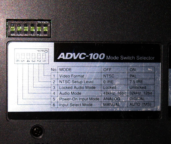

    FYI: Here are the switches on the ADVC-100
    http://www.kiva.org/about
  14. Member edDV's Avatar
    Mar 2004
    Northern California, USA
    Originally Posted by harley2ride
    Suggest that you also look at the DAC-100 and the ADS Pyro AV/Link. Both bypass Macrovision just fine, cost less than the Canopus, and do the same thing. The ADS AV/Link is highly recommended at www.videoguys.com as a semi-professional solution, and costs only $160.00, including Adobe Premiere Elements
    IMO, the two critical advantages the ADVC-100/110 are:
    1. Synced (locked) audio
    2. NTSC 0.0 vs. 7.5 IRE setup scaling.
    The latter feature allows NTSC with 7.5 IRE setup to be captured to DVD standard 16-235 digital levels. This saves hours of reprocessing black levels in software.
    The 0.0 setting allows the ADVC to capture the same way a DV camcorder would (Analog Pass-Thru mode) with analog 0.0 IRE mapped to 16 and 100 IRE mapped to 235. With this setting 7.5 IRE black gets mapped to level 32 (dark gray).
    Do the DAC-100 and the ADS Pyro AV/Link include these two critical features?

    Personaly, I would go with the ADVC-100 [and not the DAC-100] but that
    is my *biased* opinion. And, IMHO, the ADVC-100 (there were several
    revisions made to this model, and I have one of the good ones) may
    yield slightly better performance. I believe that some users that are
    having slight problems on certain source materails are on account of
    these *model revisions* ..though I can't prove it.. to date, I have
    never experienced any problems with my VHS sources. And, my VHS collection
    runs back to the early 90's. some tapes have drop-outs, blank-spots,
    and a few other serious glitchs that would drive certain capture cards
    crazy. My ADVC-100 has proven perfect captures (issue'less captures)
    to this date.
    Regarding Macrovision and the ADVC-100 device ...
    The preventitive step was not properly clear:
    ** 1 - After the mode is selected to Analog, and wait a second.
    ** 2 - you press and hold down the silver button for 15 seconds.
    ** 3 - then release it.
    ** 4 - if you find you are in Digital mode, press button again to Analog.
    ** 5 - MV should now be disabled.. until you power off the unit.
    Personally, and bias included, I would go with the ADVC-100, if you can
    find one. E-Bay should have them. If you want the optimum/sweet-spot
    one, like the one I have, look for (or make request about) the S/N
    starting with 74xxxx. If memory serves me, there were three
    or four revisions (generation) models made, and only two rev. were
    proven issue'less. This was all discussed and documented on Canopus
    website, in the forums, when Macrovision was not taken as serious as
    it is today. I registered there when I first got my unit. But, that was
    years ago, and those discussions may have been removed since.
    -vhelp 3622

    It is my belief that the talked about "oversaturated" red colors is
    a misunderstanding, and is based on older discussions which were
    not accurate/conclusive, IMHO.
    I'm with edDV here on this saturation issue. This problem is (was)
    mainly on account of the user's imporper IRE setup with their given
    source medium.
    For instance, if source medium is:
    ** Laserdisc / VCR - set IRE to 0.0 (or 7.5, depending on the source
    pre-record process)
    ** Cable / Satellite - set IRE to 0.0 (don't use 7.5 or else you will
    get high saturations, from channel to channel, source content to
    source content)
    ** DVD player - set IRE to 0.0 (don't use 7.5 or else you will
    get high saturations)
    Setting the IRE to 7.5 has its faults. And, improper settings (lack
    of knowledge of source type) will exagerate the chroma issues discussed
    below.

  27. I have the ADVC-300. It bypasses Macrovision too, but first you need to upgrade the firmware if it doesn't have the latest. What I've noticed is that the default settings in the "Picture controller software" makes the whites go up to about 105-107 IRE. Even with Auto-Gain off. So I have to manually adjust the level down.
    I think Canopus does this on purpose with their hardware and software encoder, to make things look more contrasty and "better" to most people. There is a thread here, comparing their encoder to others. It has the same contrast problem, making whites whiter and out-of-range. That is why I bought CCE Basic encoder instead. I don't like something messing around with my video behind my back. If I want more contrasty whites, then I will manually do it myself. Canopus, being a Japanese company, must not know anything about NTSC, or this was a whole design decision on purpose.
    But...I do like my ADVC as it gives great captures, after I adjust all settings. Never had drop frames when using WinDV and audio is always locked tight.
    proven issue'less.
    Could be just a coincidence, that mine works fine too. The S/N is 77XXXX just in case someone goes looking for one on ebay or somewhere. Of course, mine might be an exception. Anyone know what the S/N range is on the ADVC-100?
