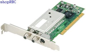

  15. The small black connector isn't s-video -- I believe it's for a pigtail. From a larger image at ATI's web site:

    Ah: And then there is this.
    http://support.dell.com/support/edocs/video/tvt1/en/setup.htm
    which one do you have SSteve?
    http://www.kiva.org/about
