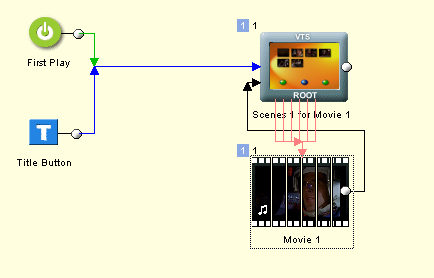

  13. Serene Savage Shadowmistress's Avatar
    Mar 2004
    Controlled Chaos
    Are you sure you did it right? Does it look like this?
    I just tried it again and used cyberlink powerdvd to test it and it works perfectly. Returns to the chapter select menu after each chapter.
    Did you test it on software or on your dvd player? If on a player, maybe it's settings override what the disk tells it to do?
