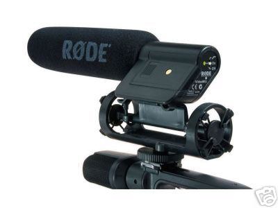

    Sony solution ECM-HS1
    Deluxe solution from RODE of Germany

  17. Originally Posted by edDV
    Originally Posted by DeZaStR
    I own a Sony DCR-TRV22 Digital Camcorder. It's a good little camcorder, except for the fact that it records "motor hum"....a high pitched buzzing sound coming from inside the unit.
    Does anyone have any experience with removing this effectively?
    Hey, Ed. Have you used that Rode mic yourself? I just ordered a Panasonic PV-GS400 and one of thsoe mics today. I read some good reviews on it, so I thought I'd give it a shot.
