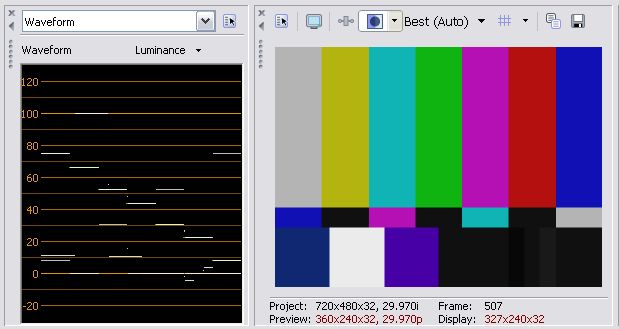

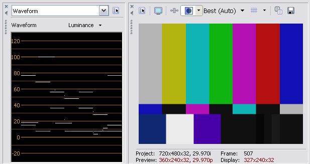

    Video transmission relies on standardized electronic signals for calibration. The most important recording and display parameters are contained in the color bar display. This is what is used to standardize the production of video and to adjust all pieces of equipment in the transmission chain including the monitor.
    This is the standard NTSC transmission color bar (with 7.5% setup) used in most of the Americas. It is the standard for analog TV transmission, VCR, laserdisc, and analog camcorder recording (including 8mm, Hi8, VHS, VHS-C and analog Betacam)

    This is the a representation of the standard color bar (with 0.0% setup) used in most of the rest of the world for NTSC (in Japan), PAL, SECAM and various MAC (multiplexed analog component) transmission systems.
    Digital video* has universally adopted the latter 0-100% levels for video production and transmission (including DV, DVD, D1, ATSC Digital Television (USA), MPeg2, MPeg4, HDV, etc.)
